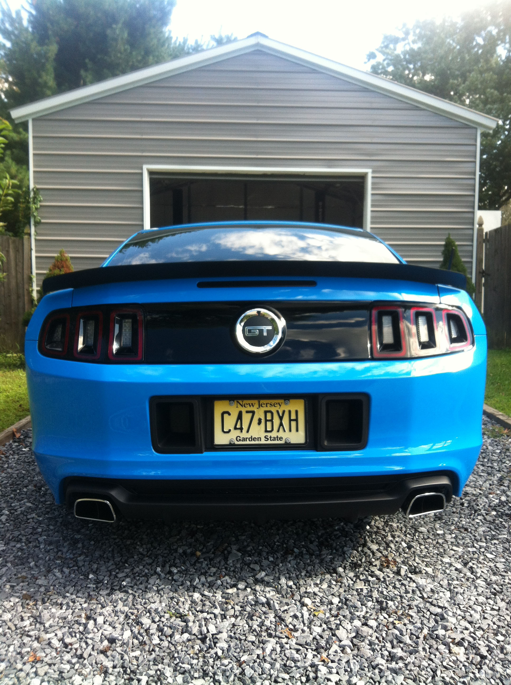

Just finished installing the new roush fascia and exhaust on my 2013 GT. I also added the rtr license plate surround and the rtr spoiler. The exhaust sounds amazing! I had a magnaflow street series with the bassani x-pipe installed but this in my opinion sounds 10 times better. I left the x-pipe on, reinstalled the factory mid pipes but I cut out the factor resonators and welded in 3" dynomax bullet mufflers in their place. Im just waiting on a new decklid panel to be released to finish off the rear but I think these upgrades really made it look just that more badass.

Very nice! Heard great things about the Roush exhaust. Love the spoiler but I got a camera and its aluminum, right? Been waiting on the RTR stuff to be released. Where'd you get the lp stuff? I want to order this week.

Thanks! The roush fitment and instructions are second to none. Yes the spoiler is aluminum, my car came with no spoiler because I was unsure of which route I wanted to go. I got the roush stuff from stage3 motorsports and the rtr stuff from classic design concepts

Hey, the order page days, "Permanent modification to the rear fascia is necessary for installation of this component."
Im curious what the mod is.

The install has you remove the rear bumper cover, cut the exhaust opening out for the larger roush exhaust, and cut about 20 various holes/slots for the fascia to attach to.

Sorry, I meant for the RTR lp surround. Probably not much of a mod there. Maybe just that the OE lp surround doesnt come out gracefully?
I have Borla sTypes but like those Roush's and late model's quad exhaust so might change to one or the other, so good info anyway; thanks.

The rtr license plate surround has you pop the old one off, then cut out the bumper cover to make room for the vents to go through. The old oem one could be reinstalled if you ever wanted to.
Ah, all makes sense now, thanks much!
