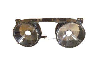

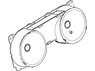

I Guess You Did Not Look At This Link.
It Shows What You Would Have Got From Ford! Likely Snaps Together on Top of Cluster. I Was Only Suggesting Getting Cluster & Swapping Lens.
https://www.fordpartsgiant.com/parts...html?pnc=10890
If You Got a New Cluster Form Ford It Does Not Come With Mask/Lens
If You Got a New Cluster From Ford It Does Not Come With Mask/Lens. So No Doubt it is Removable!
https://www.fordpartsgiant.com/parts...-10849-va.html
