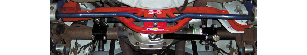

A Panhard bar attaches to the body on one side, the axle on the other. As the body moves up and down that attachment point moves up and down, but the axle side does not. The PHB is a fixed length and that means the body moves laterally as it moves up and down. The roll center moves up and down and left and right as this happens. Also in hard cornering turning left pulls the right rear down, and turning right the right rear is pushed up away from the axle.
The Watts link (and there are various types, I prefer Fays2 and Steeda and they are all I sell) gets rid of all that weird geometry change and the jacking effects. The body moves straight up and straight down relative to the axle. The right rear isn't unloaded in hard cornering and you can get power down better. And the big perk..... the rear just isn't as nervous feeling. See 20115.0's post..... Very basically a Watts link is 2 short PHB with a balance bar in between. The lateral body control is still there like a PHB, but the propeller balances the forces and lets the body move vertically without the "swing" motion a PHB has.
Take a pen, hold it steady on one side and move the other up and down--you'll see how the PHB works.
Here is a pic of a Fays2 unit: http://www.stranoparts.com/data/images/p30718170733.jpg
And a Steeda unit:
http://www.stranoparts.com/data/images/p31028132345.jpg

Replaces the PHB and PHB brace completely.
On a S197 Mustang:
