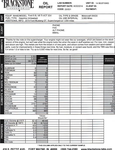

According to my first UOA report, it shows the Motorcraft 5W-20 is up to it’s task. My location is the Mojave desert and I’ve driven in hot temps up to 119* this past summer. This is my non-track/daily driver and it’s supercharged. I’ll stick with the Motorcraft 5W-20 until I see supporting data to justify running a different viscosity oil.
Ask and you shall receive,
http://www.svtperformance.com/forums...302-UOA-thread
I run Amsoil 10W-30.
A long and informative read, thanks for the link.
UOA is a good tool that everyone can take advantage of regardless of oil brand/viscosity choice.
