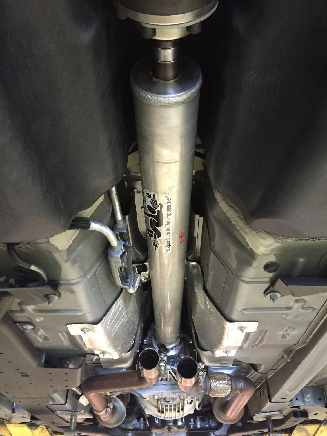

I have a 2015 GT Premium. I just purchased a DSS 1 piece shaft from Modify My Mustang, installed this past weekend and I have a tight & constant vibration from 55mph to 80mph. To say the least, I am not happy and these are supposed to be "high speed" balanced!!! Called and they said to index (rotate 180 degrees) the shaft and see what happens. Rotating this weekend and I really hope that works for DSS's sake...

I dont see how turning the shaft 180 degrees would help. Unless your output shaft or rear yoke is out of ballance. But I'm not an engineer. Please keep us posted as we are all willing to learn. Well, some think they know it all. But I'm Green with the new cars.
