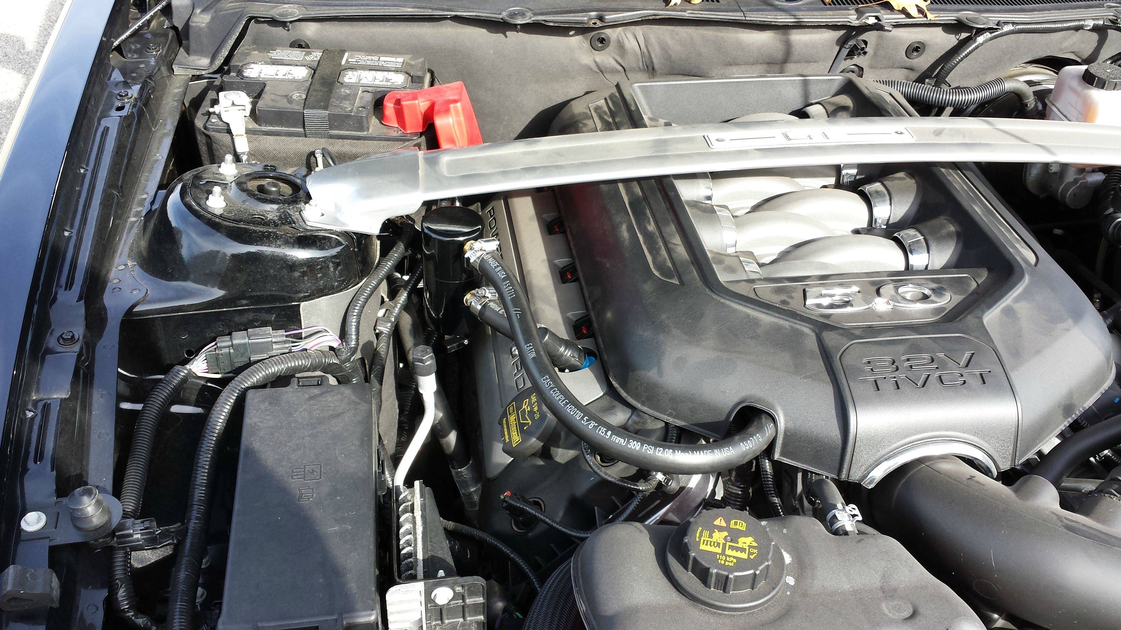

Well, Last week I ordered the Bob's oil separator because I liked the design and decided to see how it worked compared to my UPR one. When I had replaced the lines on my UPR separator a few weeks ago, I had noticed a little oil in the line going to the intake so I figured some oil was getting past the SS filter.
The UPR separator seemed to work very well in the amount of oil it was catching so I was happy about that. Today I received the Bob's oil separator and installed it. Here are some pictures of Bob's installed on my car. I like that it sits higher up than the UPR one as the UPR one hung down low enough to touch the edge of the coil cover.

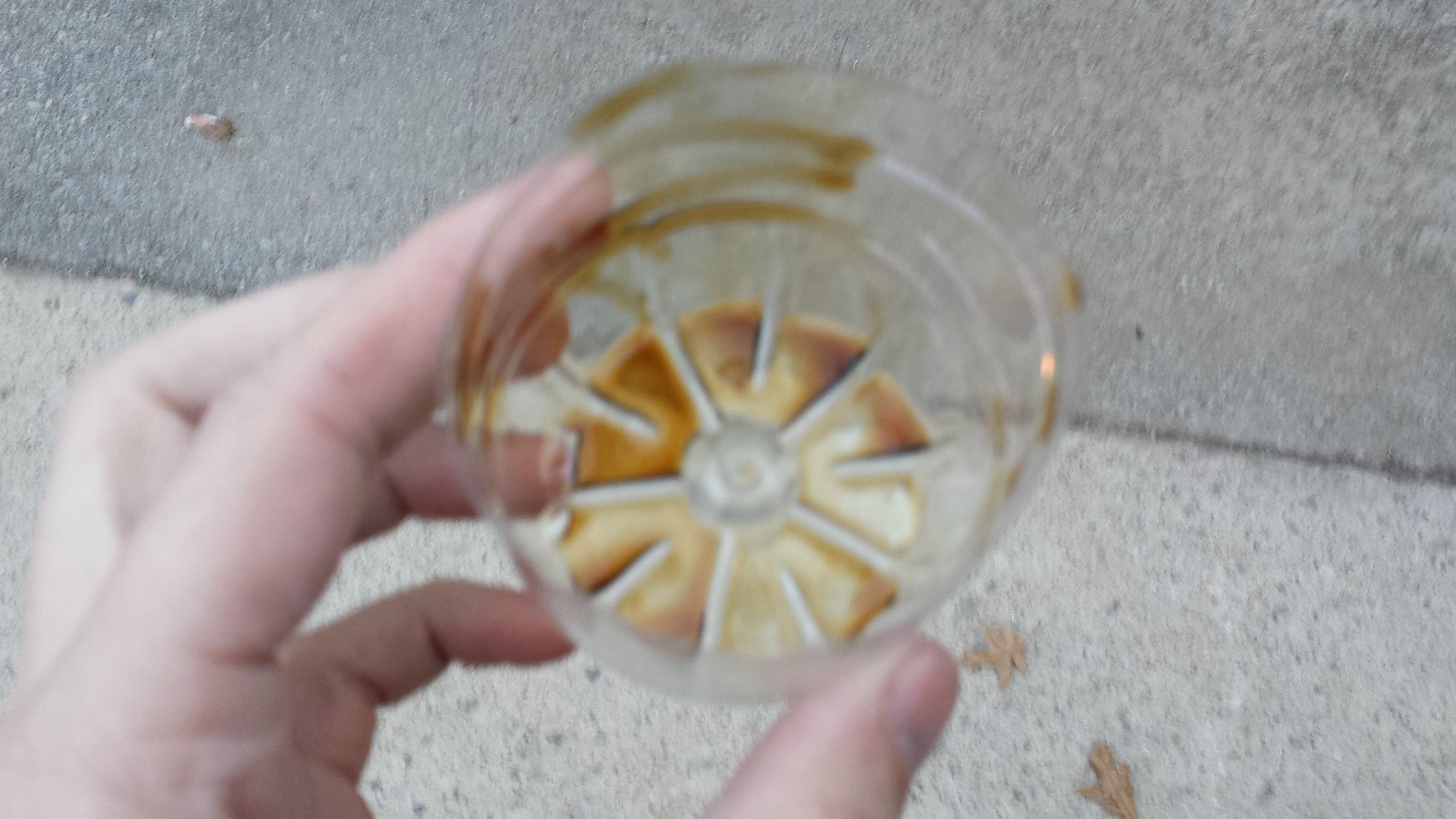

I had right at 1 1/2 tsp of oil in the UPR can with about 554 miles of driving.

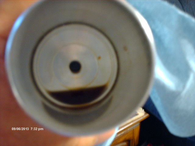

I also looked closer at the UPR can design and it is like BT's in that the top part is separated into two sides so it is not a straight through design. I guess the reason the oil is getting into the return line is that the oil is dripping onto the round perforated disc that most catch cans I've seen use and getting sucked back up into the SS mesh on the out take side and some oil is making it's way through the mesh.
On the UPR can, the metal that separates the two sides of the connectors does not go all of the way down to the round perforated disc so the oil can actually sit on this disc and flow over to the part of the disc that covers the out take side. On the UPR can, this disc is kept in place by a rubber O-ring vs the two screws on the BT can. The metal appears to go all the way down to the disc on the BT can which I would assume would make it harder for oil to travel over to the out take side of the disc.

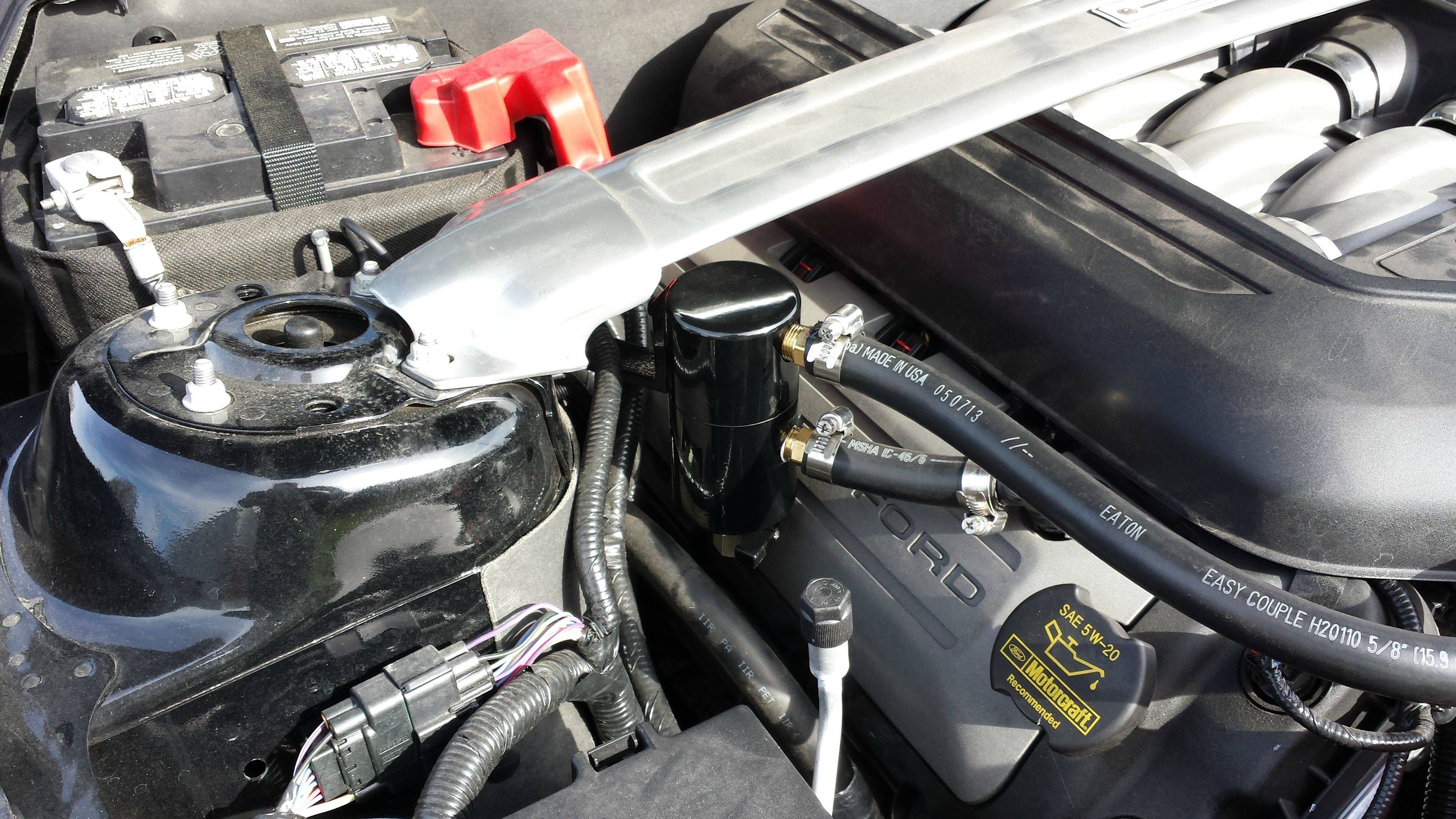

For the bobs catch can install. I used the following:
3/8" Socket Wrench
8mm Socket
13mm Socket
Flat Head Screw Driver
Razor Blade

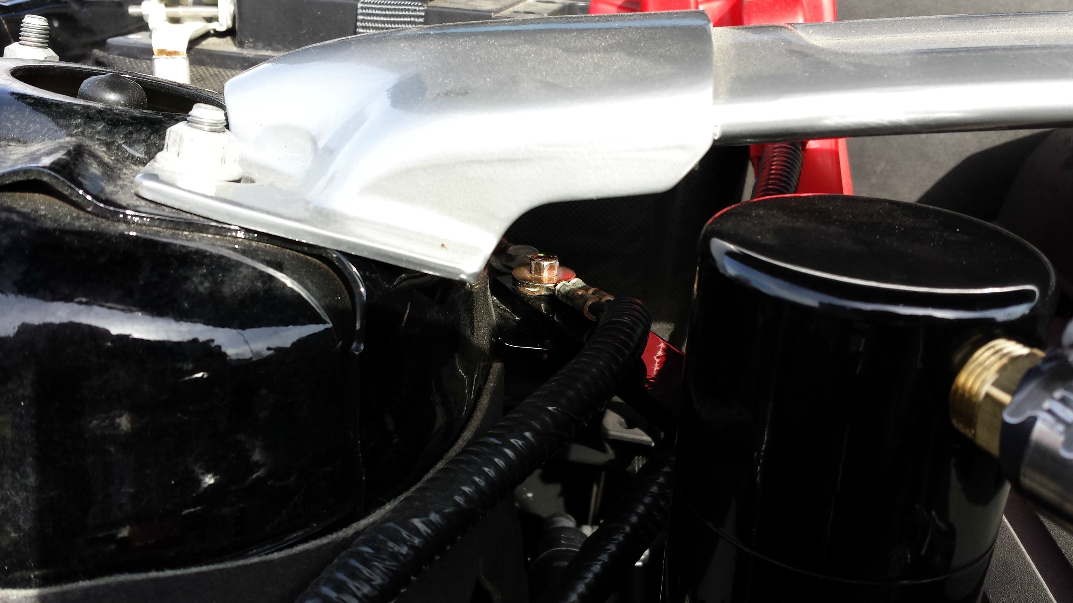

Install is simple. You just remove the strut bar using the 13mm socket. There will be 6 nuts total. After that you remove the ground wire with the 8mm socket and then flatten out the tab on the ground wire. Then install the bobs catch can using the supplied bolt. Once that is done, I popped off the engine cover just by firmly pulling straight up. Remove the stock PCV line and then using the razor blade you cut off the fittings from the PCV line.
The bobs separator comes with one long hose that you will cut to size. This is probably the hardest part. I recommend doing the shorter hose first. After that you just put the worm clamps on and tighten them to the OEM connectors and the bobs catch can. Reinstall the engine cover and strut bare and that's it! Super easy install. Everything is very accessible and the tools needed are fairly common. Install difficulty: 2/10.

Nice installation directions. I only had to remove 4 nuts for my strut tower brace and I found that I didn't have to bend the tab on the ground wire as it just hung over the edge of the catch can bracket. I also installed the short hose first. My can was put together pretty tight but I was able to open it.
I didn't cut my factory PCV valve pipe up to get the connectors. I just bought some new replacements from Ford so that I could just put on the stock setup if I needed to for some reason.
