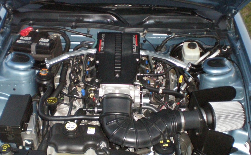

Will the Saleen fit under a factory 2010 strut bar?
Old Apr 21, 2010 | 07:07 PM
Ltngdrvr's Avatar
Joined: February 18, 2010
Posts: 4,990
From: S.E. Texas
I believe it will but you should check with some of the installers like Brenspeed who is a vendor on here.
Old Apr 21, 2010 | 08:41 PM
SC67Stang's Avatar
Joined: February 18, 2004
Posts: 660
From: Houston, Texas
If not there is a nice Strut tower brace that will work with the Saleen Blower.
Yes it goes thru the blower.
