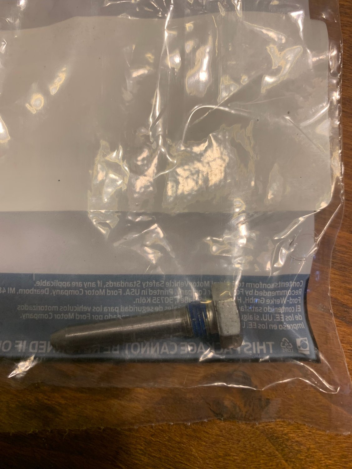

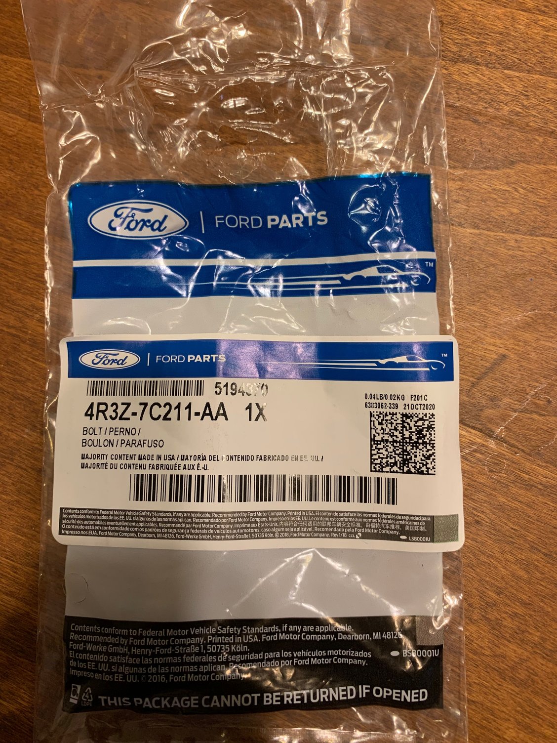

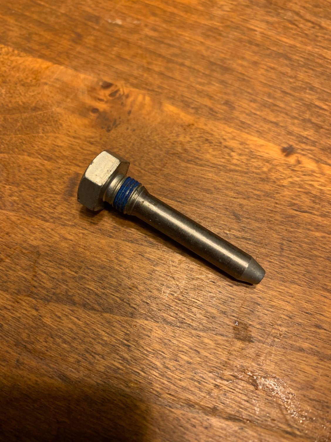

I was following for the same reason but just got mine in and installed. The part number is: 4R3Z-7C211-AA It costs $14.95 from Ford. See attached pics for part number confirmation and the actual bolt. Hope this helps and gets you back shiftin and driftin!
