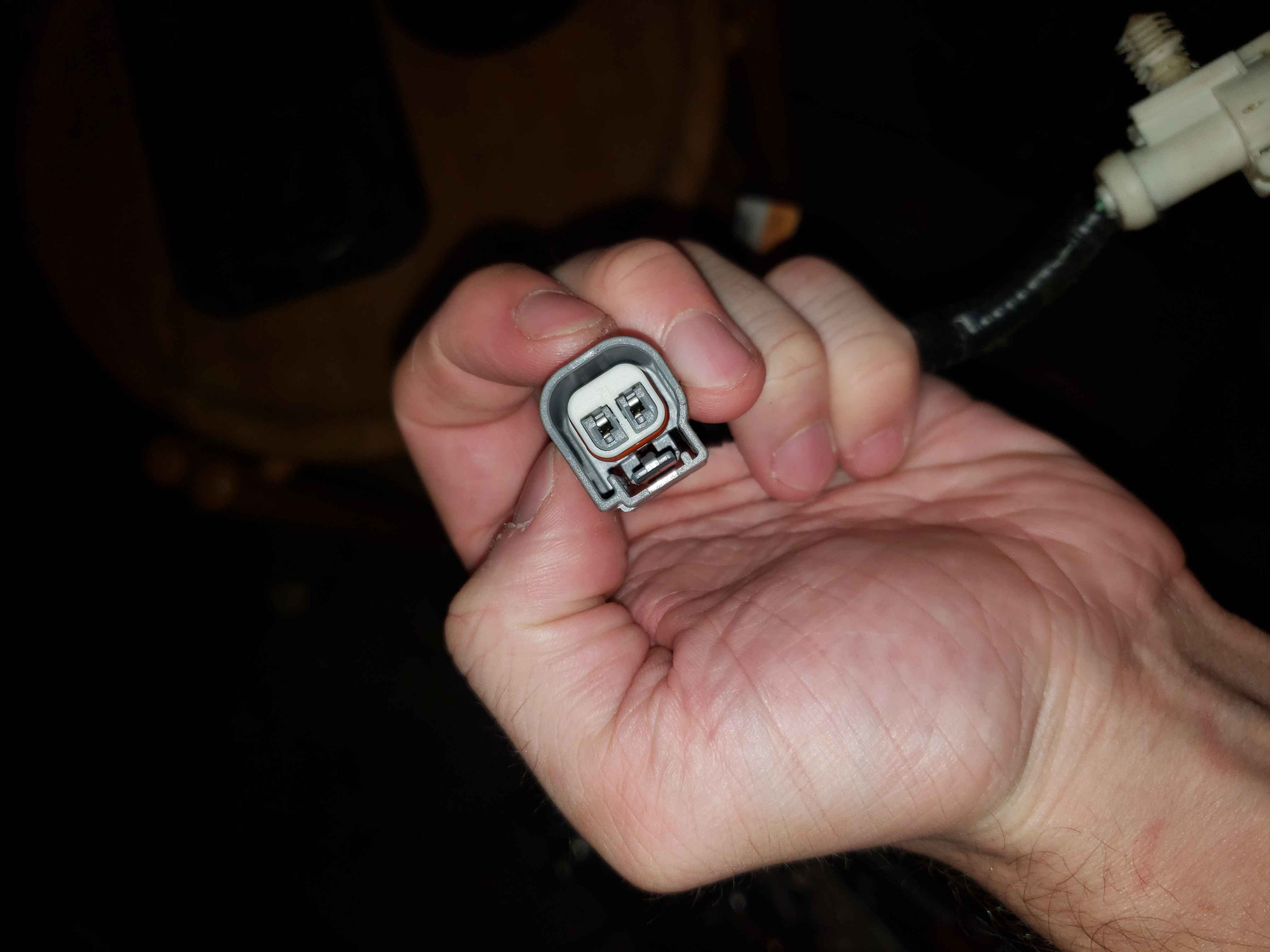

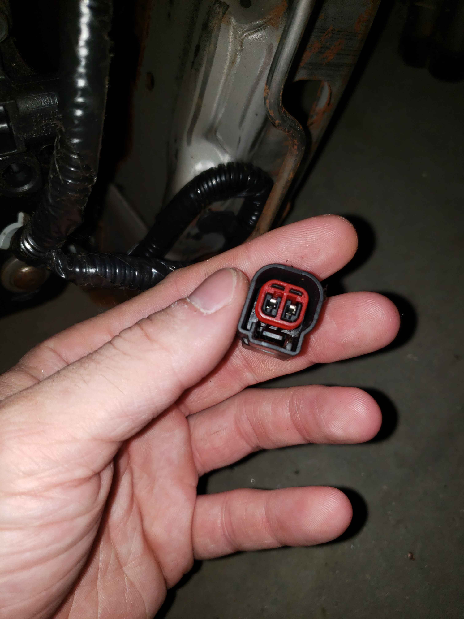

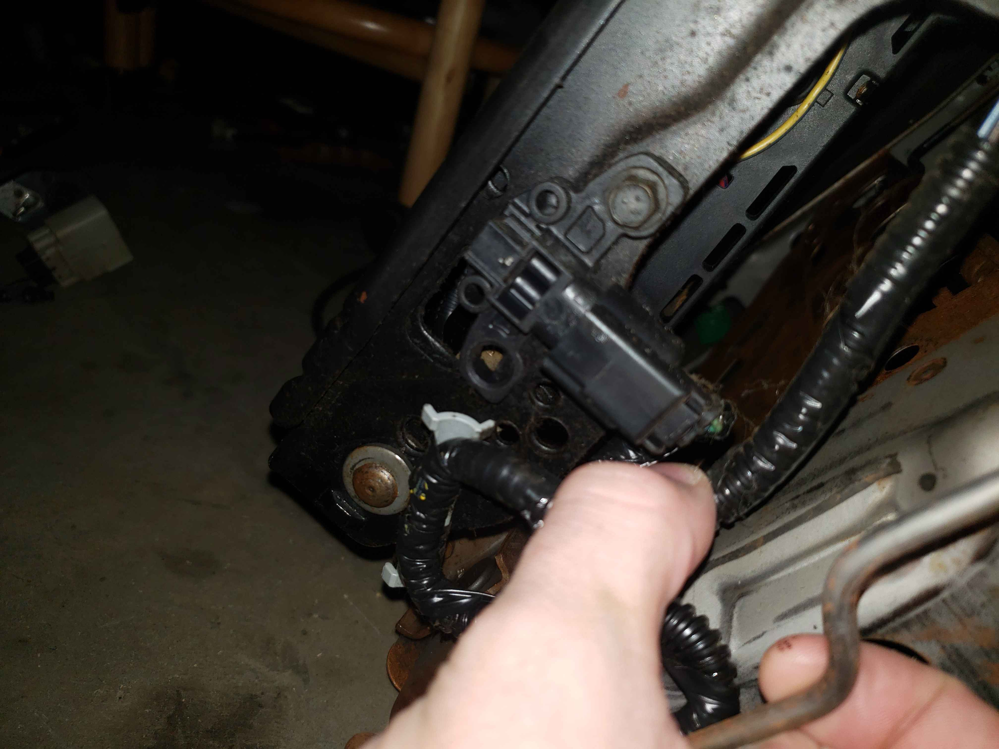

Oh sorry lol
Mine's a 2008, the other one I'm not sure but it did have a seat airbag (which had been used).
The only thing I kept from the junkyard seat was the frame, backrest and seat pad are from mine (which has the airbag unused). Plug for the sensor looks the same on both harnesses.
Would I be fine without the sensor then?
Here's the manual plug, the power sensor, and the power plug.
Old Oct 23, 2025 | 07:28 PM
05stangkc's Avatar
Joined: November 27, 2004
Posts: 12,594
Likes: 4,347
From: Visalia Ca.
The Non Seat Airbag Cars Need This, Your Harness Should Have it on it!
Maybe What You are lacking! Anyhoo You Need One Without Seat Airbags Somewhere!

Old Oct 23, 2025 | 07:29 PM
tmaaan54's Avatar
Joined: October 22, 2025
Posts: 8
Sorry, mine DOES have an airbag. It just hasn't gone off like the other one.
How important is the seat position sensor? I also just realized the seatbelt sensor would have the same issue though; it's on the main harness too, and I was planning to just let the car think I'm not buckled in. But would that stop the airbags from going off?
