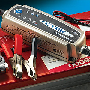

I bought a Ctek 3300 off ebay and it arrived today. I plugged it in and the indicator shows the battery as half charged. It's been on for about an hour. That little charger gets pretty hot.

I don't think that you will ever chase down all of the battery drains on these cars.
1. Shaker head units
2. Anti theft
3. Window sensors
4. Ford P.O.S. oem batteries
I got this to help out the situation and I think it's a good investment.
