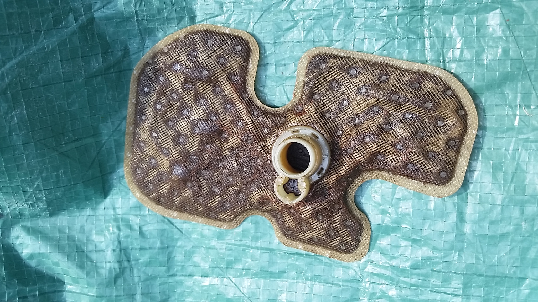

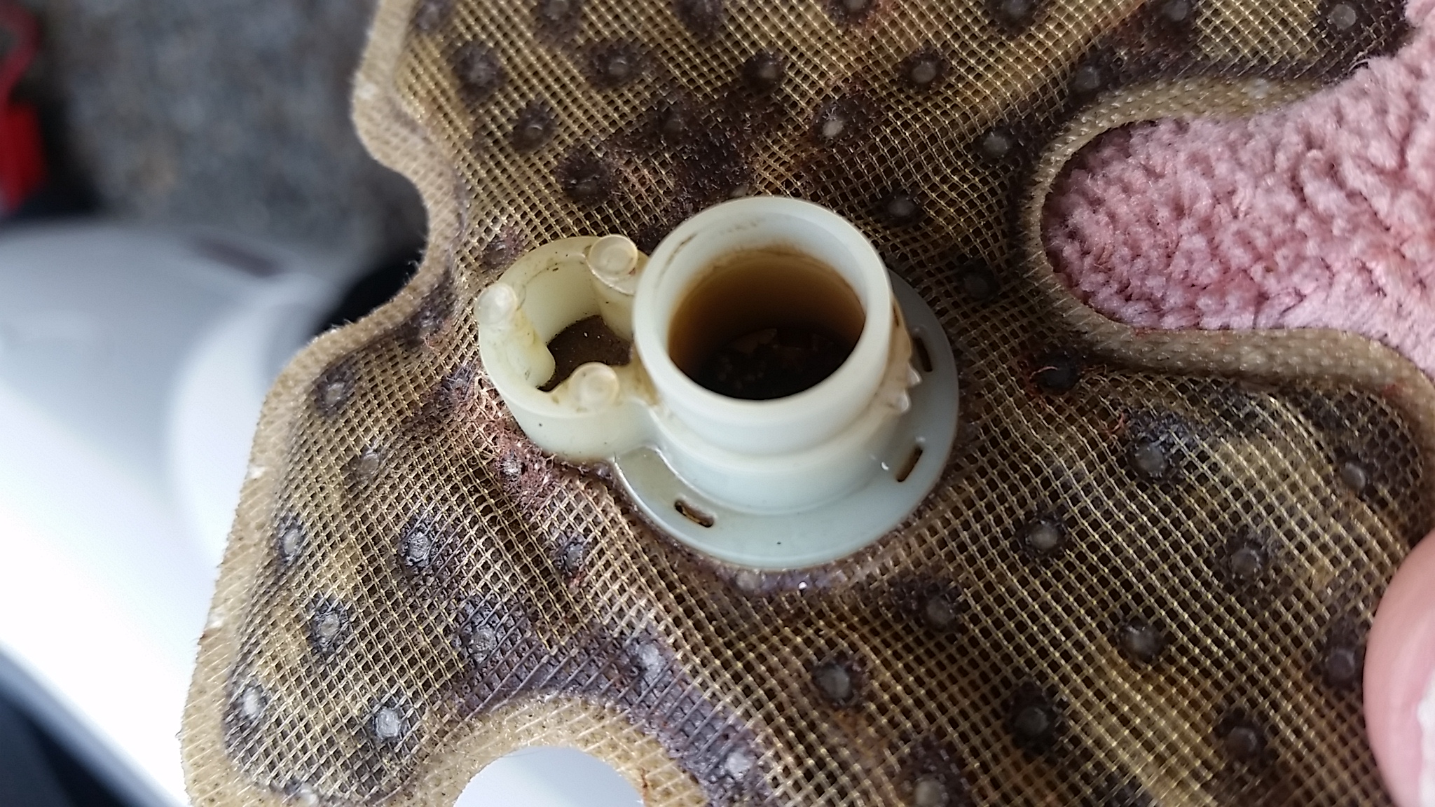

I have an 07 gt/cs I started to have the sputtering problems when heated up worse .
Changed fuel filter it was ok , cleaned & tested every fuel injector was ok to.
I then tried the techron treatment.
then a new fuel pump was ok for 2 months then it failed a pump part , so I returned it clear & blew out the original pumps sock or pick up & everything was good. So what I deduced is the amount of crap that gets in our fuel tanks every time we fill it. last june/July every parts store ran out of pumps, It took about 3-4 months it cams back , I immediately pulled my pump & sock was all covered in silt 😠(better than getting to the injectors. so I washed out my tank cleaned sock again then 6 months later again it started pulled pump looked in tank full of silt.
So all we really need is the socks or pickups on the bottom of the pumps, but I cannot find anything for these, I'll have to make one or change pump style no way I'm buying a new pump every 6 months for BAD gas.
