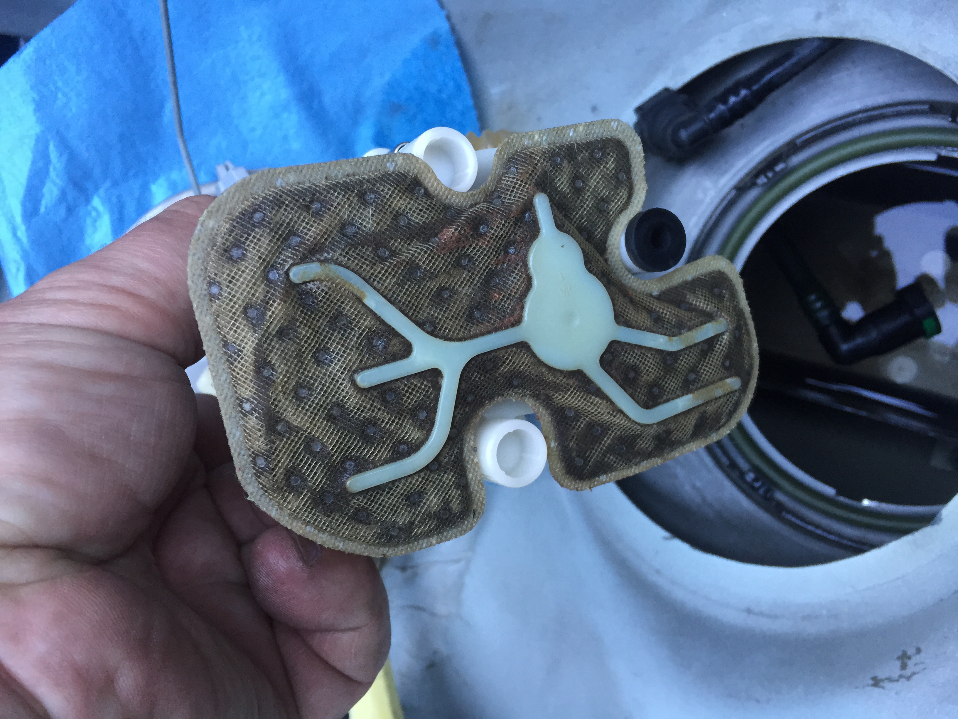

I have to pull my fuel pump & clean my pick up or sock like every 3 months there so much crap in the gas seems to clog & restrict the flow enough to bigger it down that it **** near was having a heart attack going up a hill , after a clean it goes like snot.

Pulling the fuel pump would probably be a PITA. Sounds like changing it more often than not is best. I haven't heard anyone say their filter was clean when they changed it.

Not that terribly hard to get to the pumps, but never heard of anyone ever doing that, on a Mustang, let alone any other car for PM.

My filter was always clean pulling the pump is so so easy 1/2 hour tops depending how long you clean & blow out old pick up

The white round part on the bottom gets sucked up when the sock clogs up & starves for fuel your car starts running like crap when warm & can't get up a hill after cleaning & put back I get 80-100 kilo more a tank & goes like snot. Oh I have flushed the tank and the crap I red tested the gas I buy & it's in it, I filled a separate container and had a friend test it for contamination . It came other the fuel.

What the heck is that? The fuel filter is under the driver side door not in the tank. Why would you pull out the tank filter? Unless they came up with a completely different design my 09 has it under the driver side door sill.
