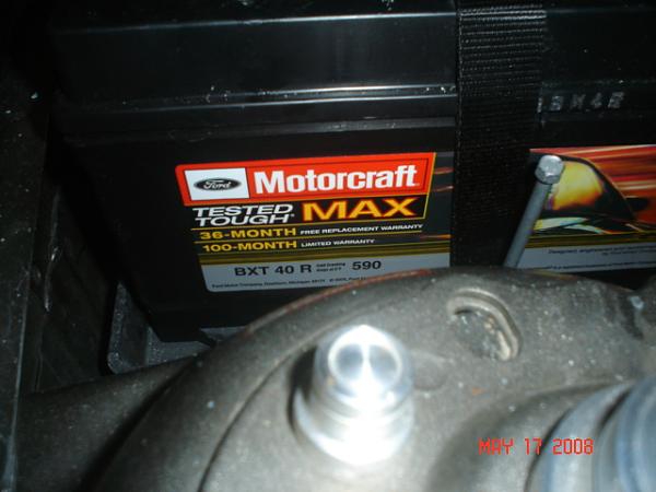

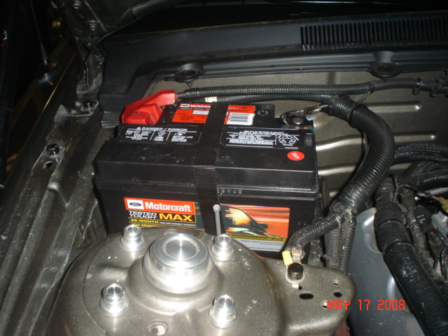

Old May 17, 2008 | 12:25 PM
  #89
MTAS's Avatar
Posts: 2,298
From: Tampa FL
Thumbs up
Originally Posted by mrkabc
Add me to the dead battery club...
Car ran fine last night. Today... turn the key and just a single click. Stone cold dead. Time to get a new one. Any issues with the BX40R (upgraded battery)?
I can't say you guys didn't warn me!! The OEM battery didn't even last 3 years!!!
I just put the BXT40R in my car yesterday. Not only is it electronically bigger than what was in my car (the BXT96R), it's physically bigger as well. I had to use only one of the chocks that held the stock battery in there. But it's in there nice and snug. I paid $108 and gave them the BXT96R that was in my car, as a core. If memory serves, that's about what a comparable Interstate battery costs.
