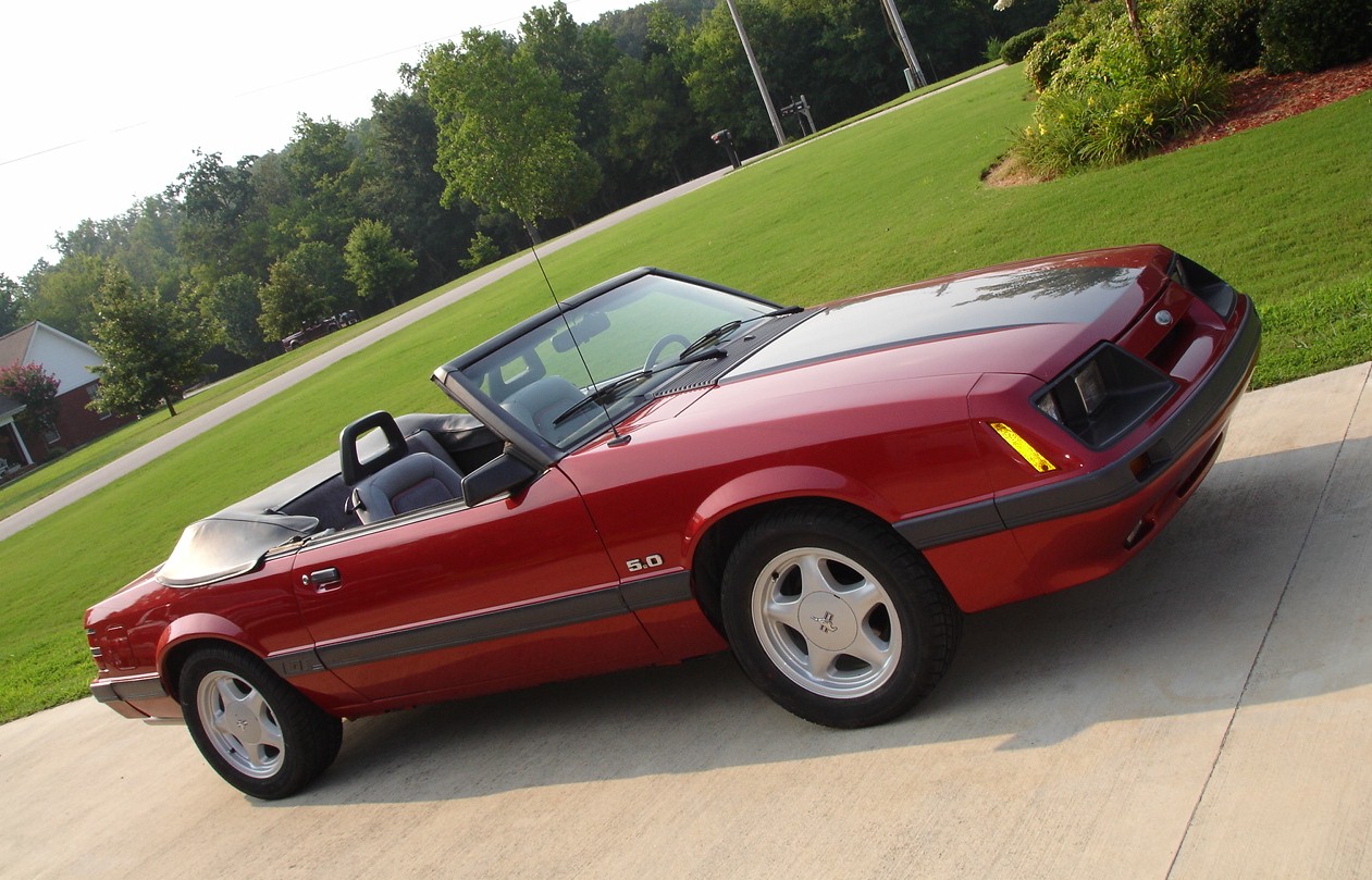

Ralph, just trade me for my 85Vert and be done with it.. I will fix your engine and you can fix my rear quarter windows...
Old Aug 29, 2008 | 06:22 PM
  #52
KEEP's Avatar
Joined: February 25, 2007
Posts: 311
Just think about it..........

Those wheels are Nice! :-)

*laughs*
Okay, trade.
