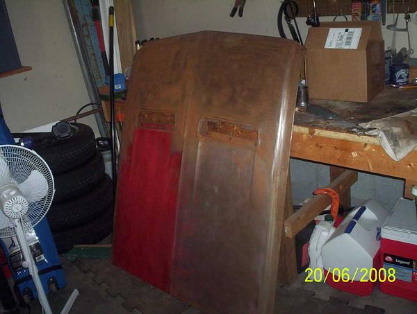

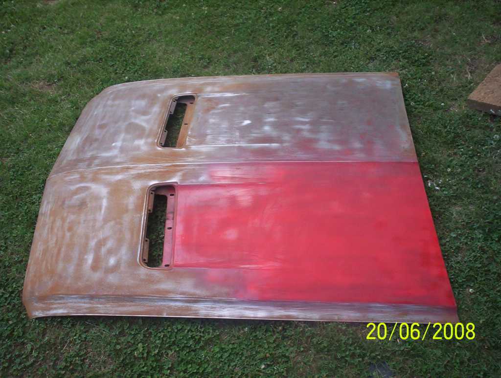

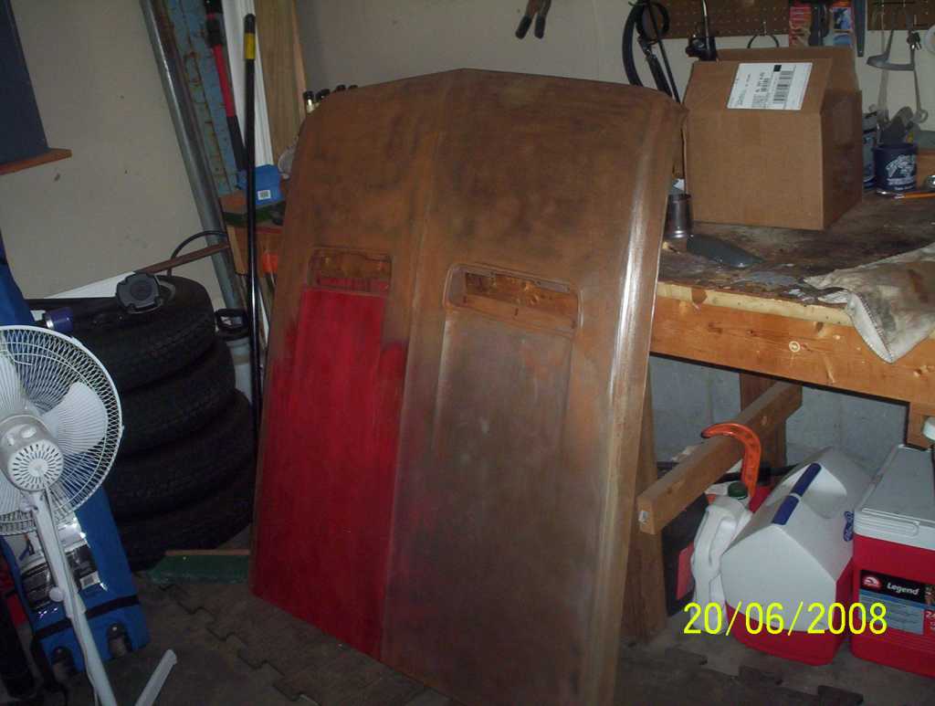

Here are some pics of the hood so far. Got it sanded down. Might get it primed tomorrow. www.photobucket.com/gthood

Your pics at the link you provided were too dark for me to see. Why don't you post pics directly in the thread you have started or are replying too? kennyg
Old Jun 20, 2008 | 02:36 PM
BA Mustang's Avatar
Joined: June 29, 2007
Posts: 4,133
From: Huntsville, AL

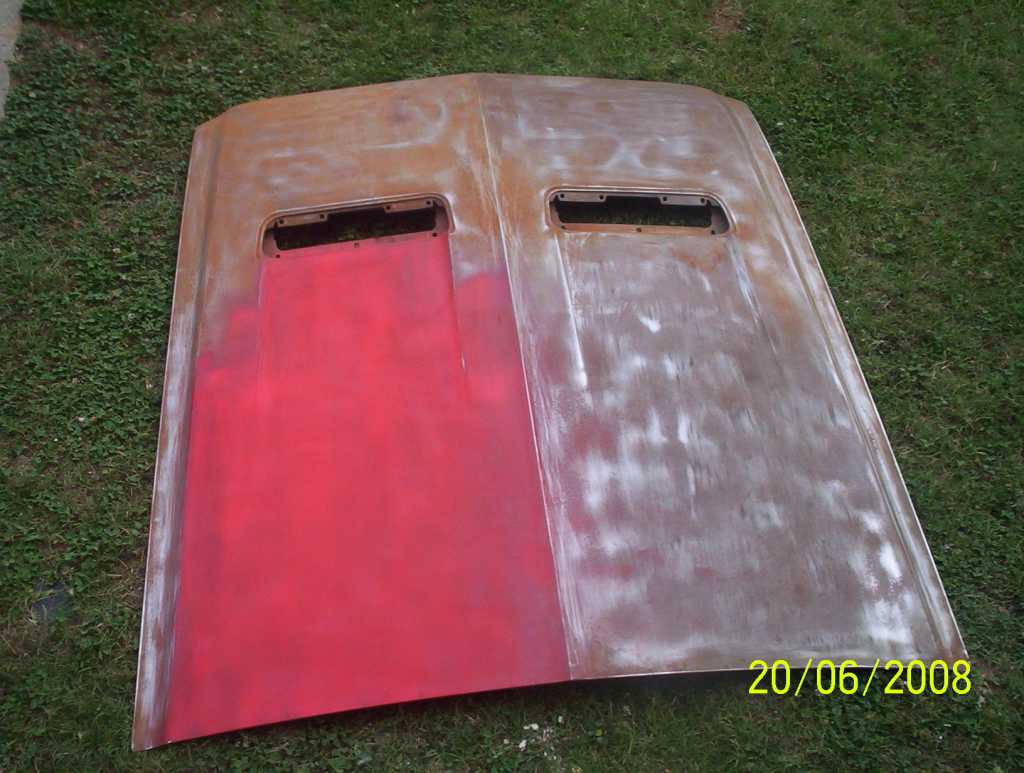

I guess it is easier just to post a URL. I will take some more pictures. That was when I had the garage door closed.

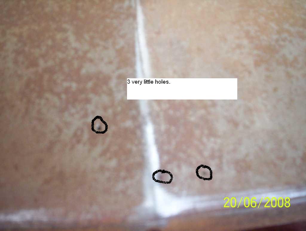

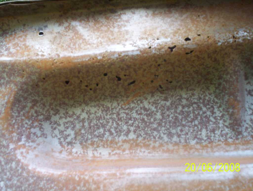

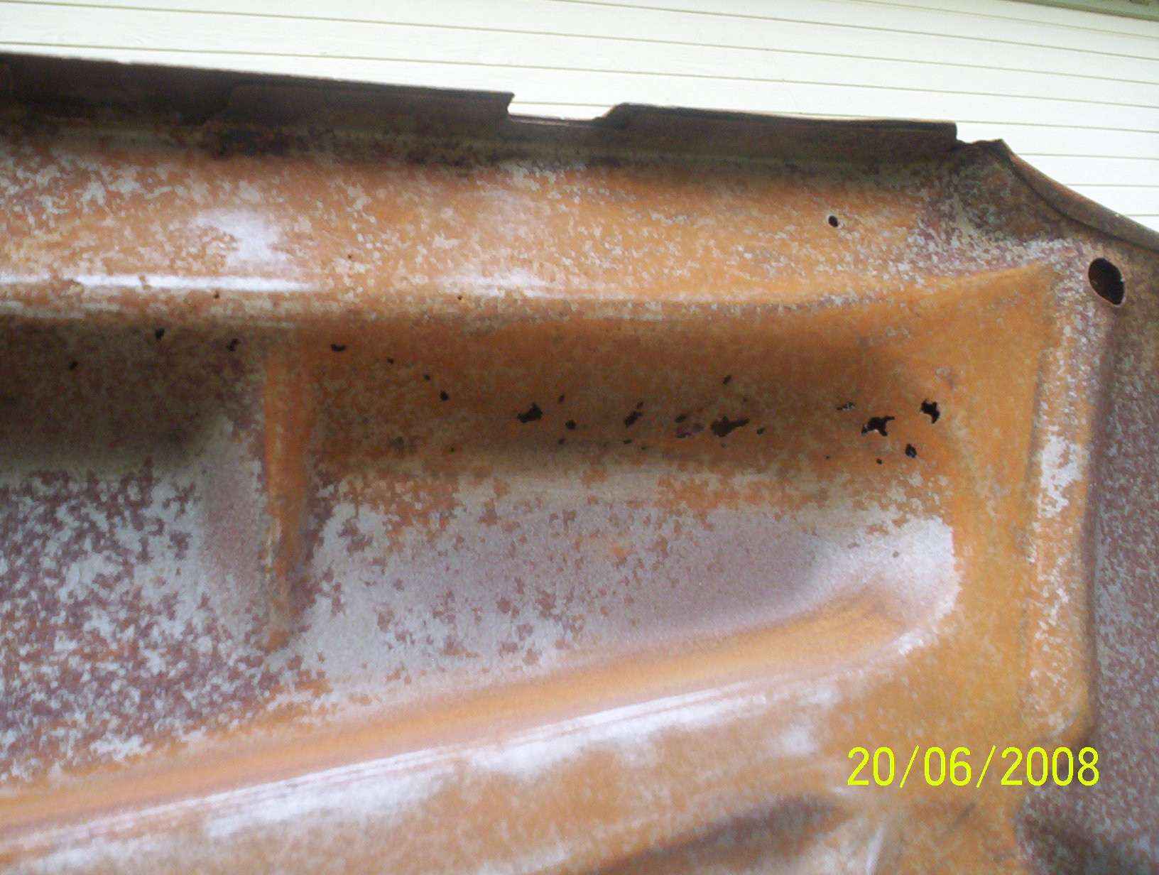

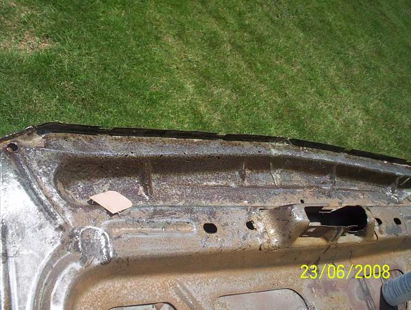

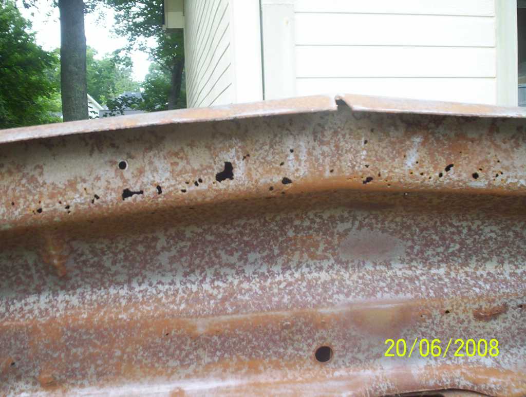

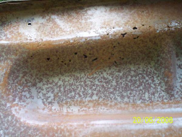

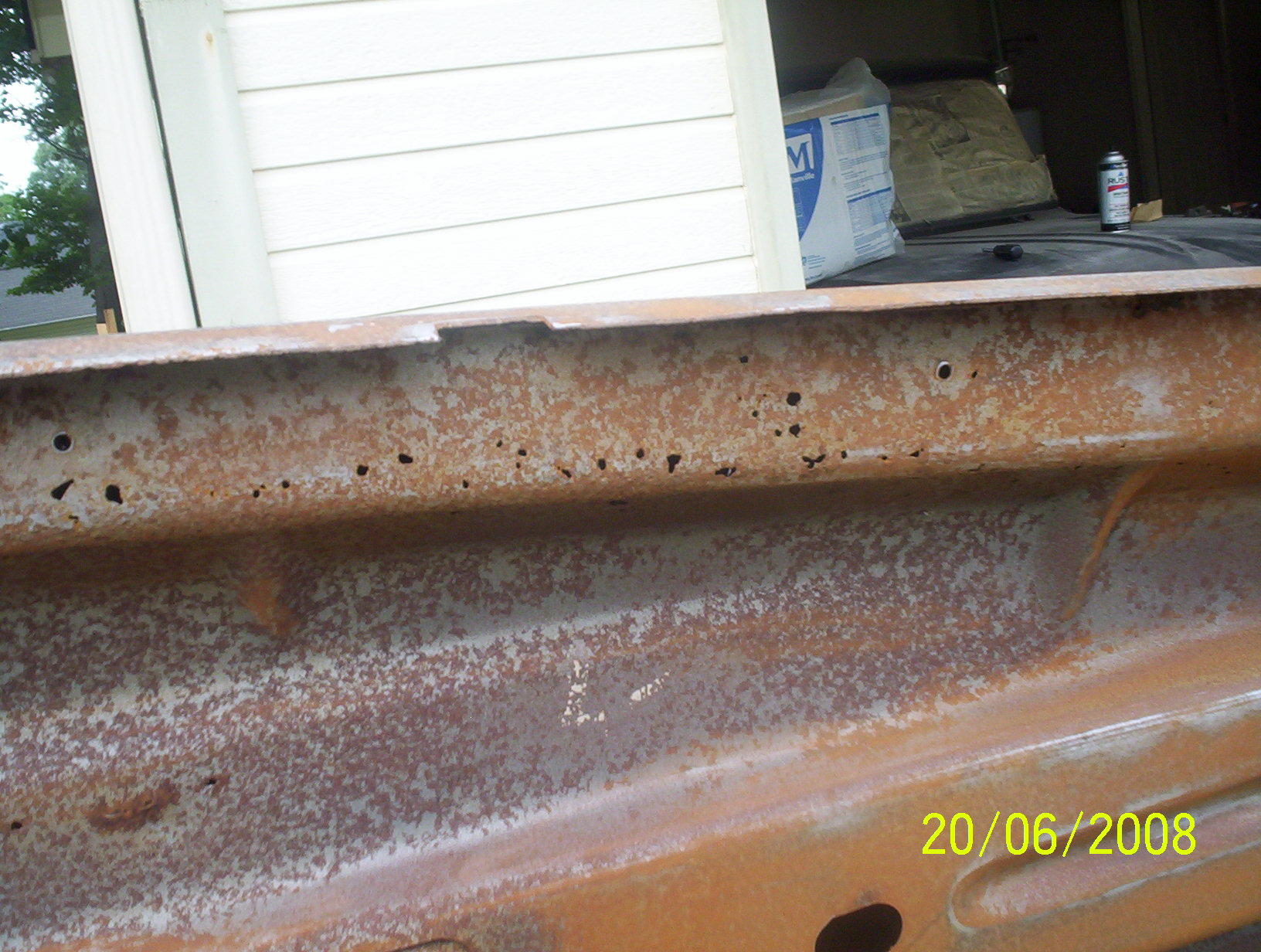

Here are some more pictures. Also pictures of the rust we have to take care of. Either going to buy some metal and replace those pieces or bondo over. Still have to sand the underside.
NEVER bondo over rust! It will come back and soon.
Old Jun 20, 2008 | 08:17 PM
kennyg's Avatar
Joined: January 23, 2007
Posts: 1,296
From: Flintville, Tennessee
Those pics are much better! What's in the box on the workbench? Huh, huh?Inquiry minds want to know! mgreene is right about the rust issue. The proper way to fix it would be to find another hood and cut out the whole front 2-3 inches of the inner structure and weld it in. The GT, or turn signal hood is a nice option. It was found on GT's in '67, and fairly common on '68's, especially 6 cylinder Sprints. kennyg

That is beer making material for my dad.
What about fiberglass? Could I fiberglass over it?

Do you have a welder? Most of those holes look small enough that you could fill in the holes by welding them. Then its smooth, prime, smooth, paint.

The problem with fiberglassing, is that you're not really fixing the problem (same with welding up the holes). If the metal surrounding the holes is still rusty, it's only a matter of time until it starts to bubble as well. The only correct way to fix it is to cut out the rusty metal as far away from the holes as necessary to get to good, clean, unoxidized metal, and weld a new patch piece(s).

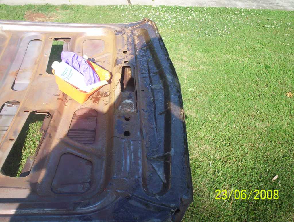

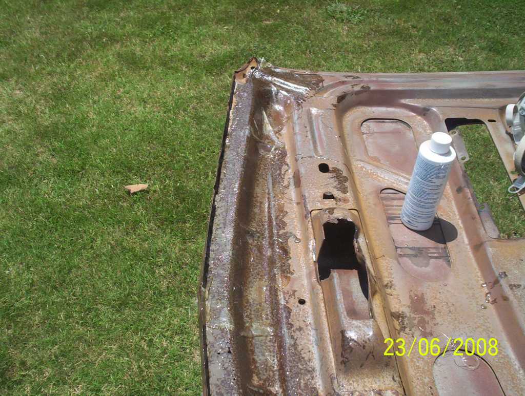

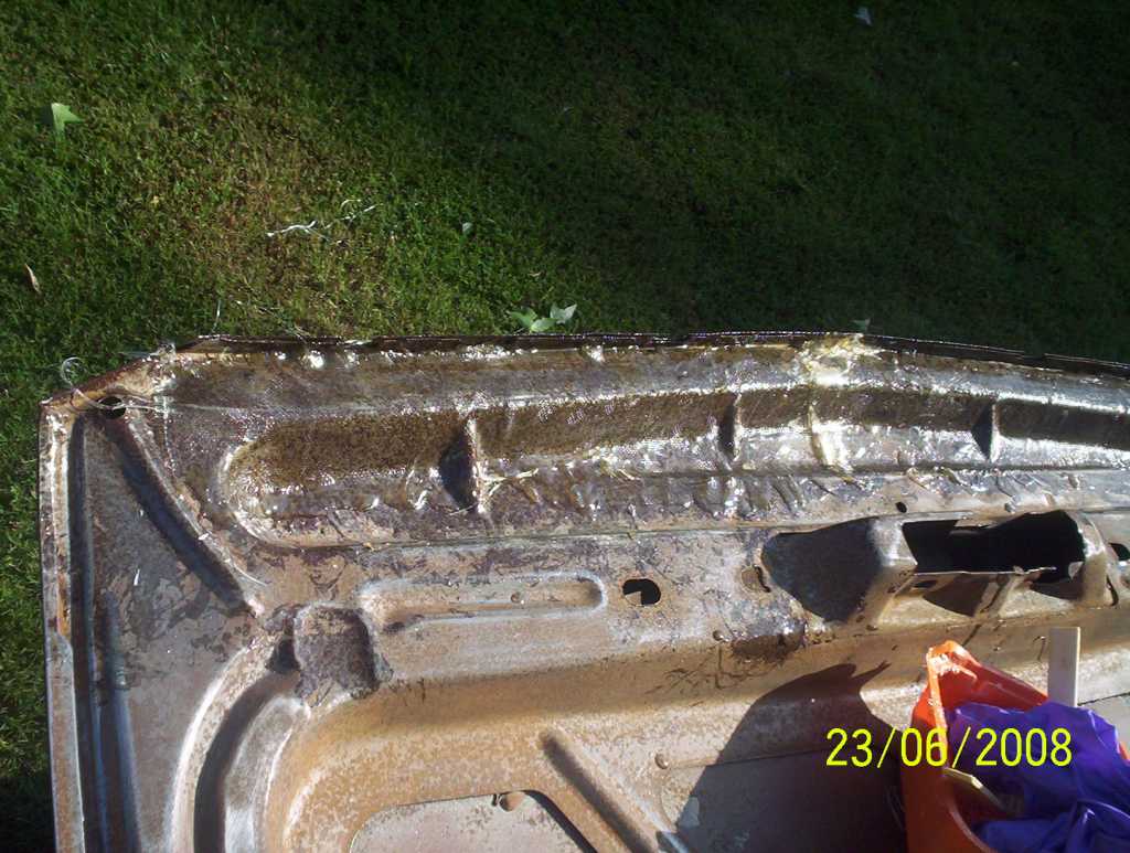

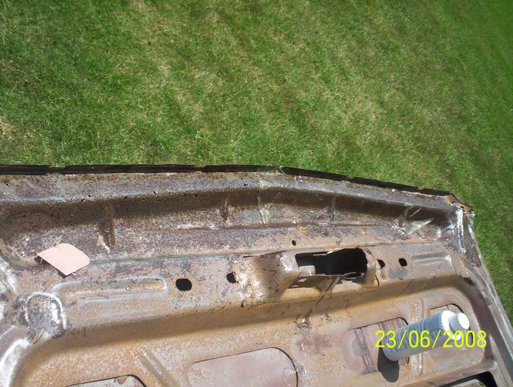

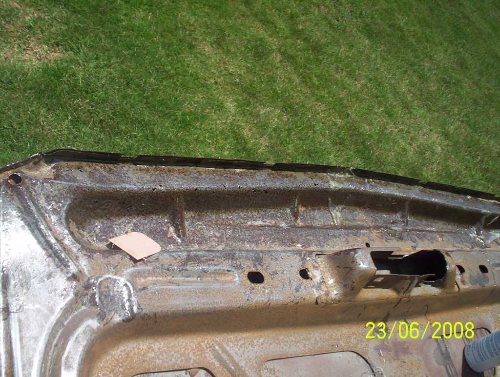

Here are some pictures. I already found out a suck at fiberglassing. Still have 2 sheets of fiberglass I can use. Just don't have any hardener.
Attached Thumbnails Paint Style?-106_6931.jpg   Paint Style?-106_6932.jpg   Paint Style?-106_6933.jpg
Old Jun 23, 2008 | 04:27 PM
BA Mustang's Avatar
Posts: 4,133
Went out and bought some hardener. Finished it up. Just have to sand it down and prime it.
