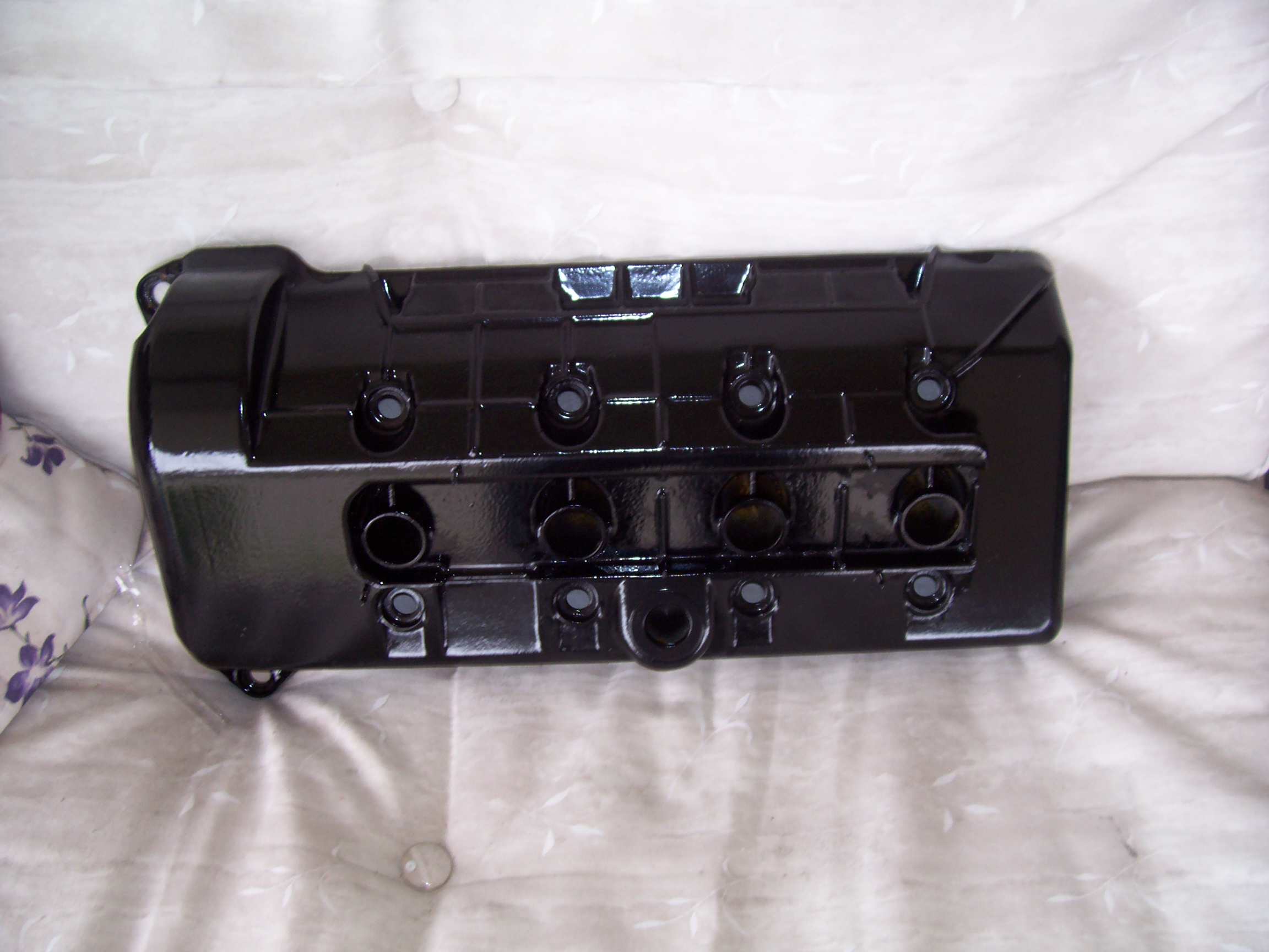

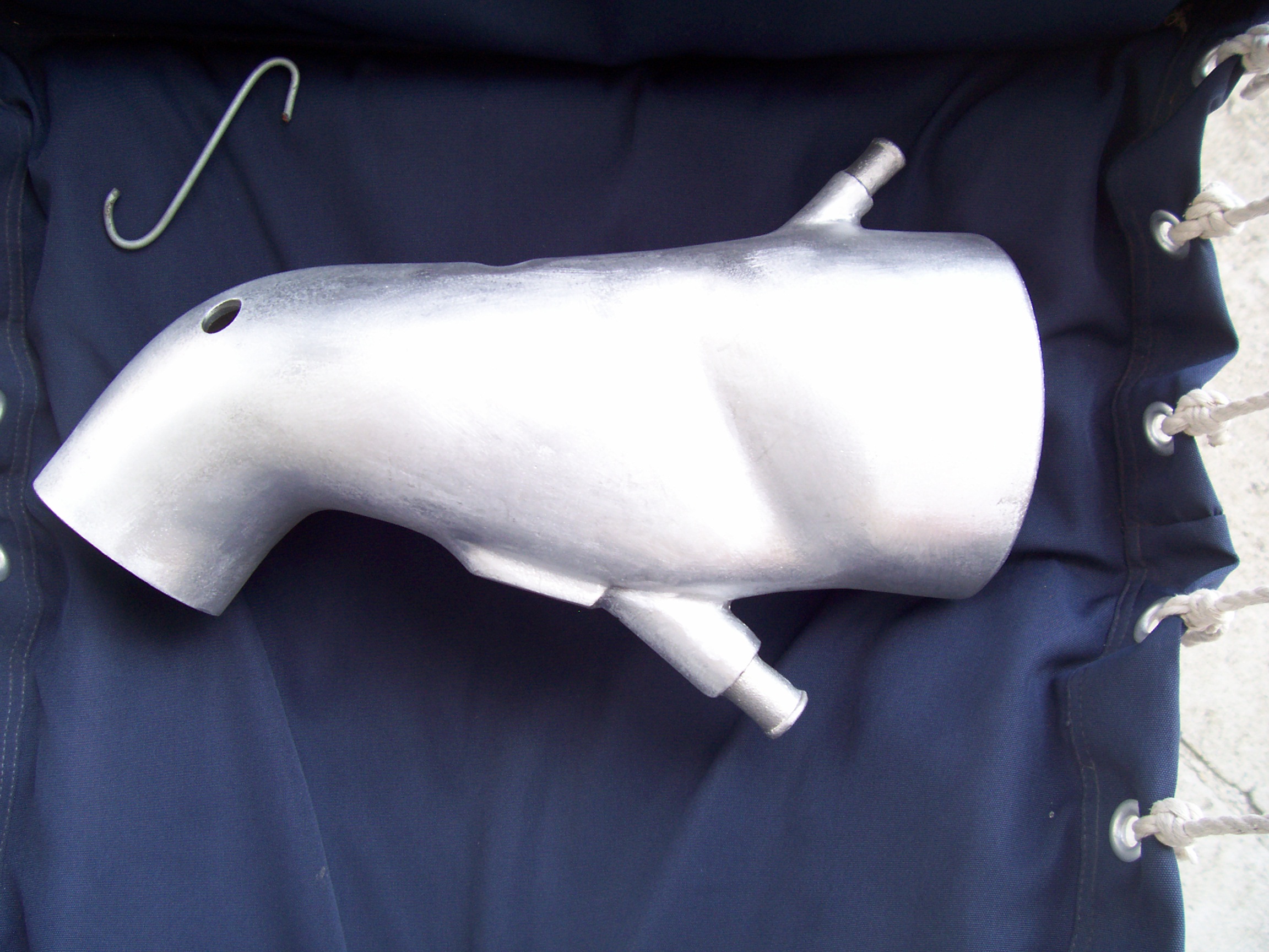

Latest project,
I bought a C&L intake tube and sanded down most of the casting flash and removed the C&L logo.
I will coat it chrome to match the intake hat that I did in chrome as well from Page 2.
Also a picture of a valve cover that I did in gloss black.
Although, I think that black valve covers, with the black/polished intake hat and a chrome inlet tube may look pretty good.
I plan on doing the inlet, some covers, cobra brake calipers on one day soon.

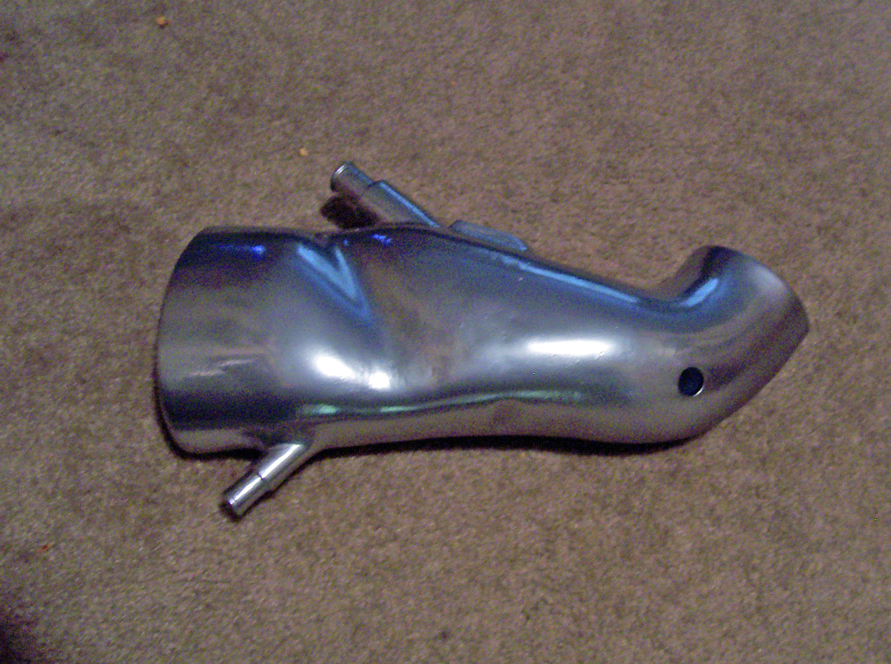

I went out and did the C&L intake last night.

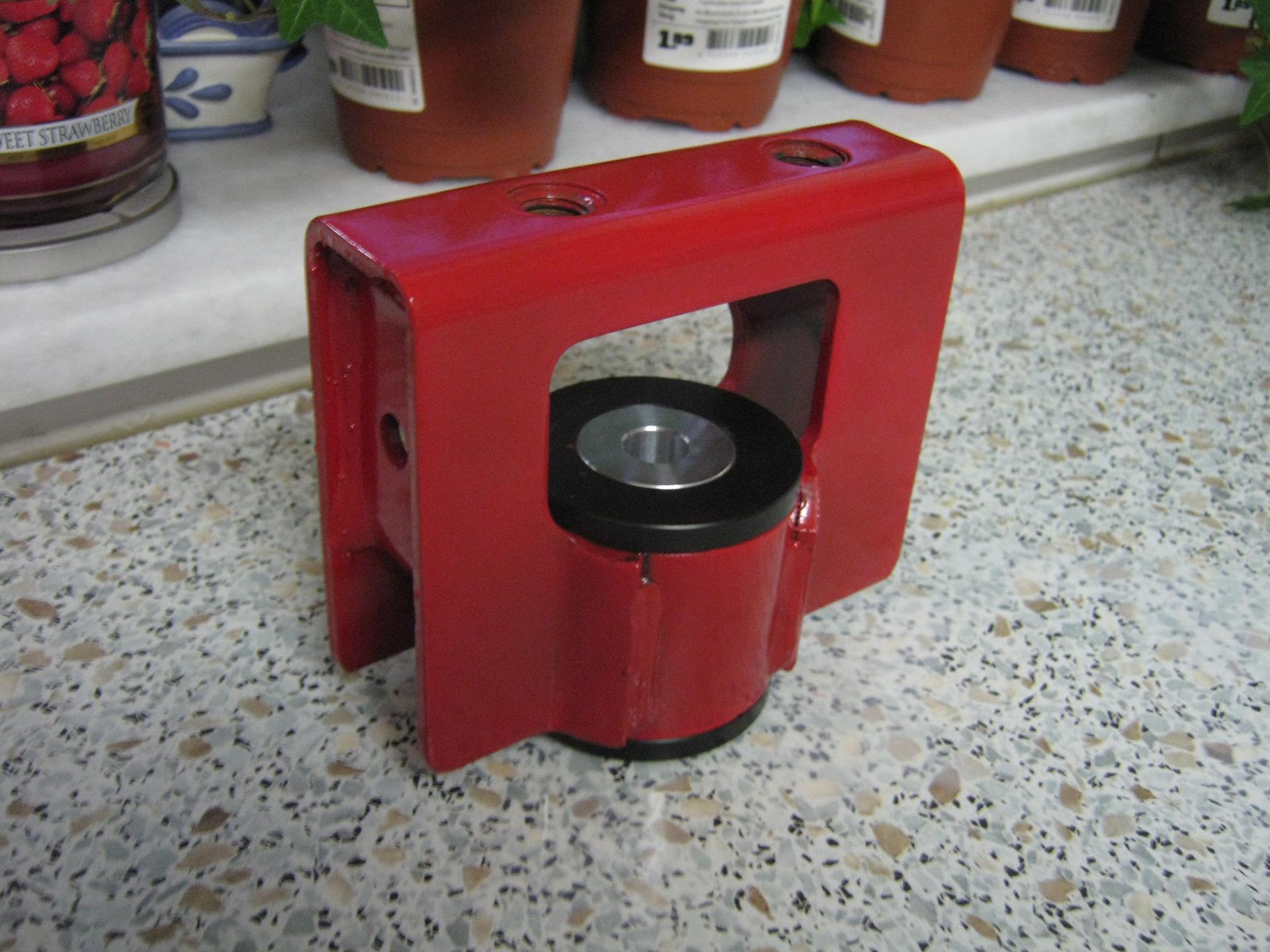

I use the Chicago kit, I use heavy gauge wire to suspend the parts and connect the ground to the wire. The C&L was supported from a wire from inside the PCV tube. Cobra upper hat was suspended by wire inside one of the bolt holes, etc.etc.
I just did my rear diff mount and installed my delrin bushings today. Here's a pic of the final product.
