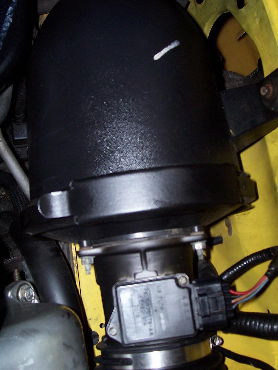

I did my MAF meter today. I did it in a black Matte finish, it turned out pretty well. I also did some scrap with the yellow to see if it matched up to the Cobra but it didn't.
I could probably coat the calipers in yellow and with them being behind the rims you wouldn't notice the difference.
What do you think?
I'll post some pics of the meter later.

I know it's a bad pic but here it is.
