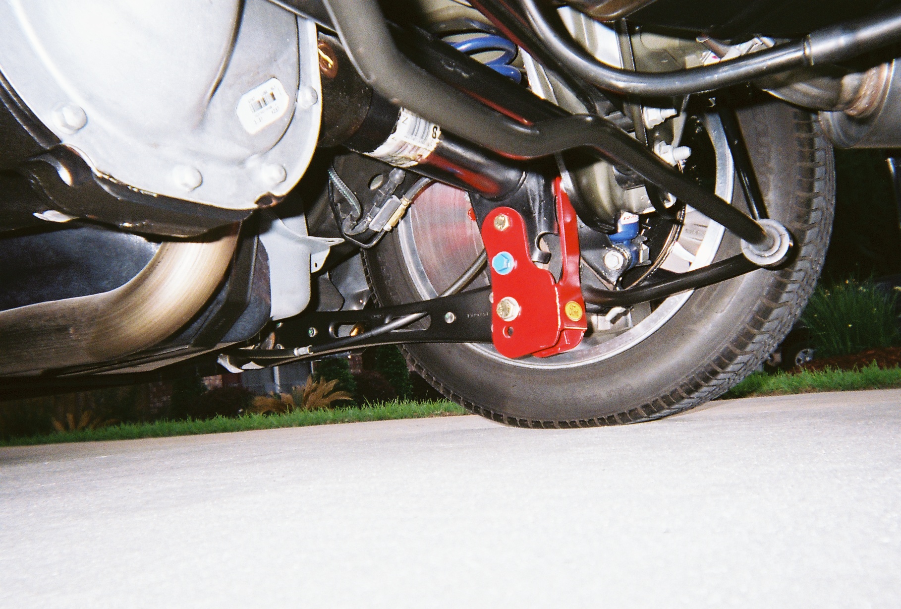

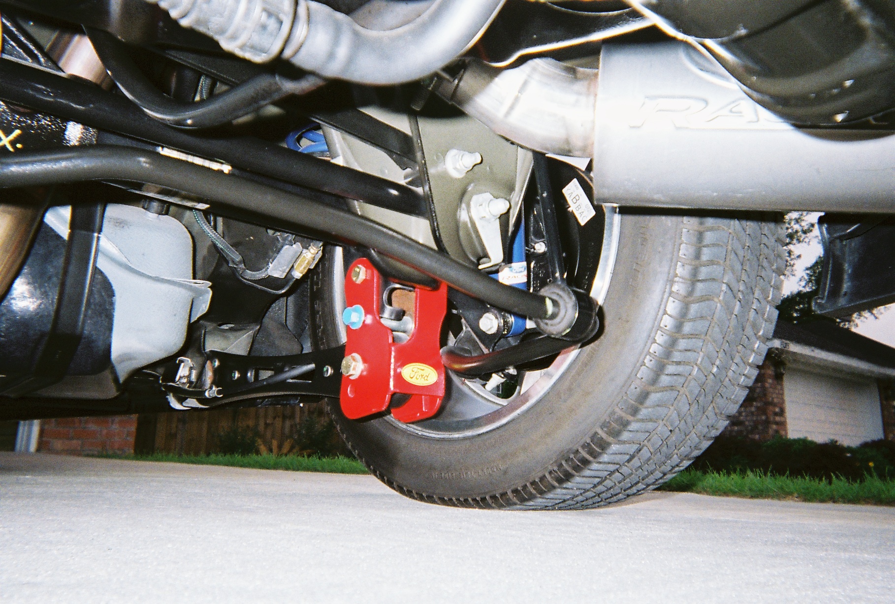

OK, just to clear things up. We're talking about 3 different sourced LCR relocation brackets, BMR, CHE and the UMI brand that Rick has. The problem area appears to be the passenger side mount. The BMR brand only has one hole for the mount, one of two choices for the LCA and one on the tab that extends up to the axle mount. The UMI that Rick has have two holes for the mount which would appear to eliminate the possibility of the bracket being able to rotate and bend like the picture of the BMR that 06GT kindly provided the link for. However the CHE brackets appear to mount the same as the BMR in the links provided. So it would appear they would be subject to the same failure possibility as the BMR. From what I can tell by studying all these pics for the last 30 minutes is that the UMI brackets that Rick has mounted appear to be superior to both the CHE and BMR. Just my 2 cents.
I bought the UMI ones, then used a grinder on the upper edge. I installed them and had them welded just to be sure. I may never put enough force on them to bend them but it's cheap insurance so why not.

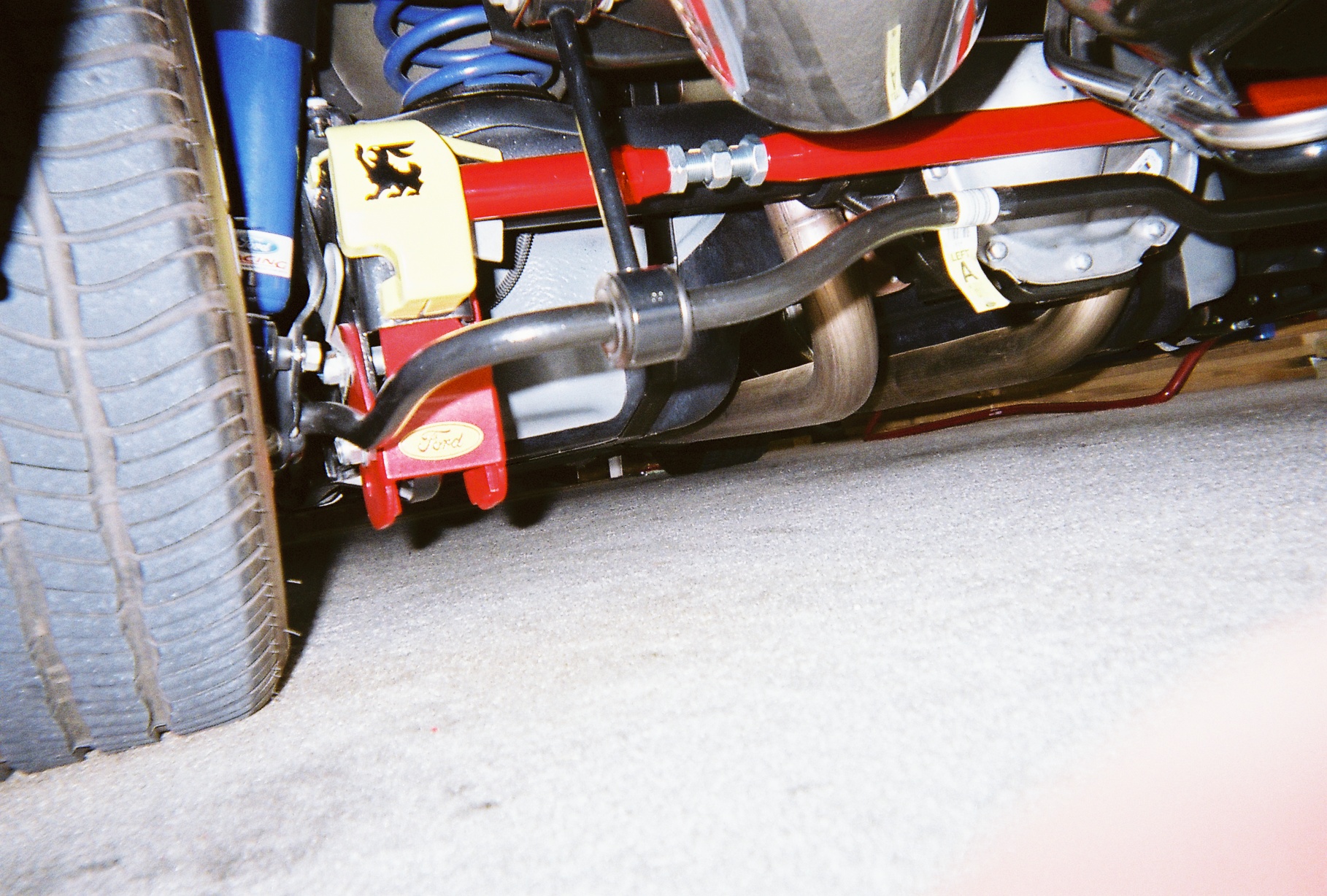

[quote=NJ3;5886820]I bought the UMI ones, then used a grinder on the upper edge. I installed them and had them welded just to be sure. I may never put enough force on them to bend them but it's cheap insurance so why not.[/quote],,HERE ARE SOME MORE PICTURES of the ones Shelby Parts sell now,,,do you see any differents in the two ,Lower Control Arm Relocation Brackets.-med_gallery_28618_1141_105691.jpg

update ,,,I got this coming in the mail ,[ATTACH][/ATTACH]
got it ,its pretty cool ,I will try to get it installed soon,

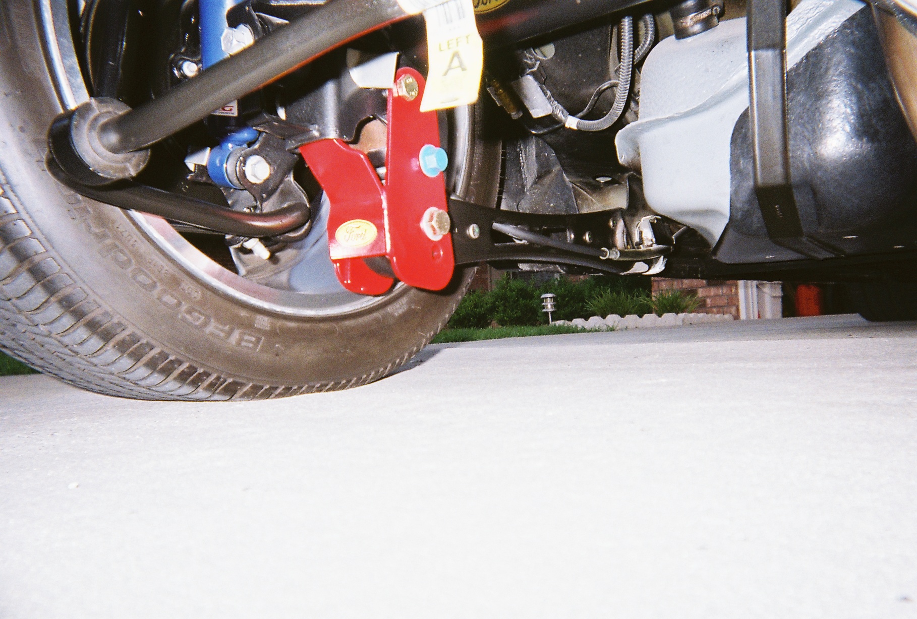

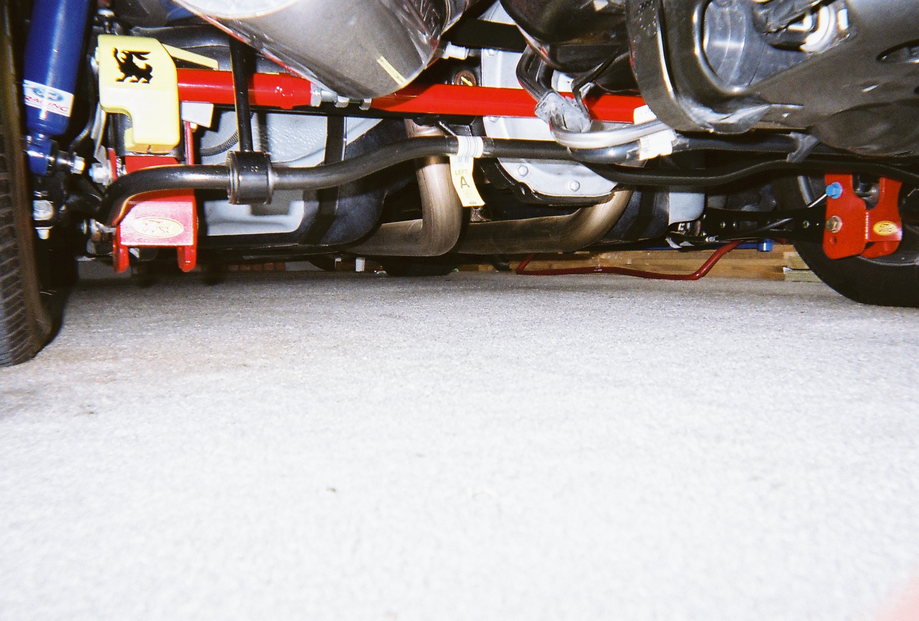

see ,,there you go using that word again ( racing ) why I got to be all that ,your going the make people here think bad things about me,Lower Control Arm Relocation Brackets.-rearmods01.jpg
here are a few ( file ) pictures that might help someone.just trying to keep some of you guys and " girls "/ ladys out from under the car / stang.

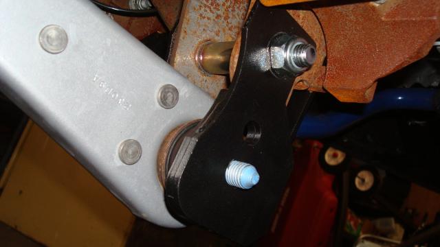

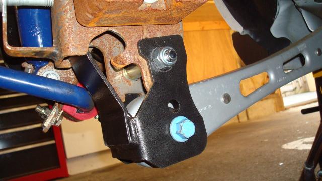

well ,,,its in sorry I crack myself up sometimes,here are a few pictures so for ,more pictures later after I get done installing the " NEW "rear Eibach sway bar,Lower Control Arm Relocation Brackets.-551428-r1-10-15a.jpg

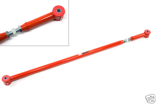

Lower Control Arm Relocation Brackets.-551428-r1-23-2a.jpg new UMI Performance -adjustable panhard bar
