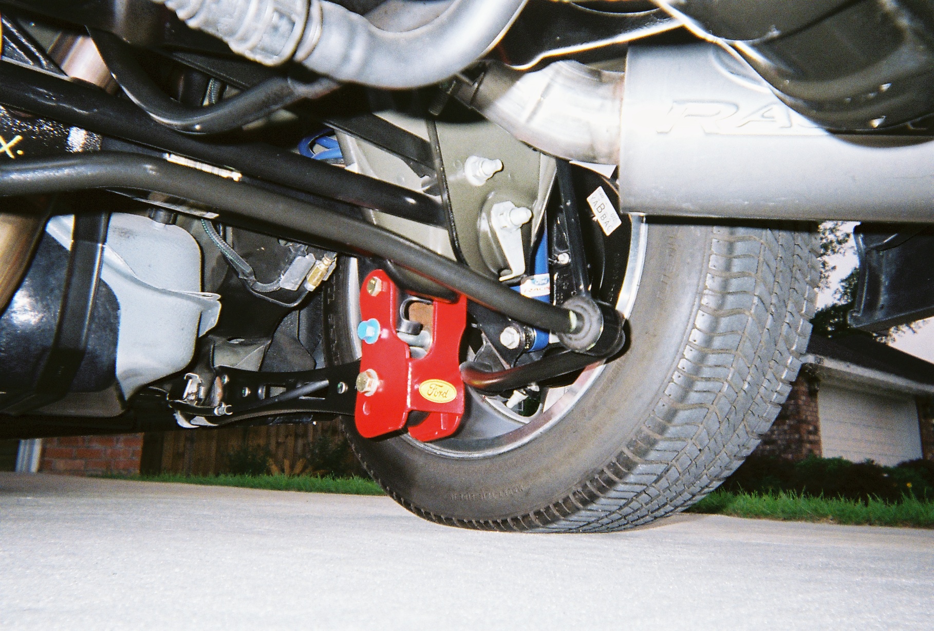

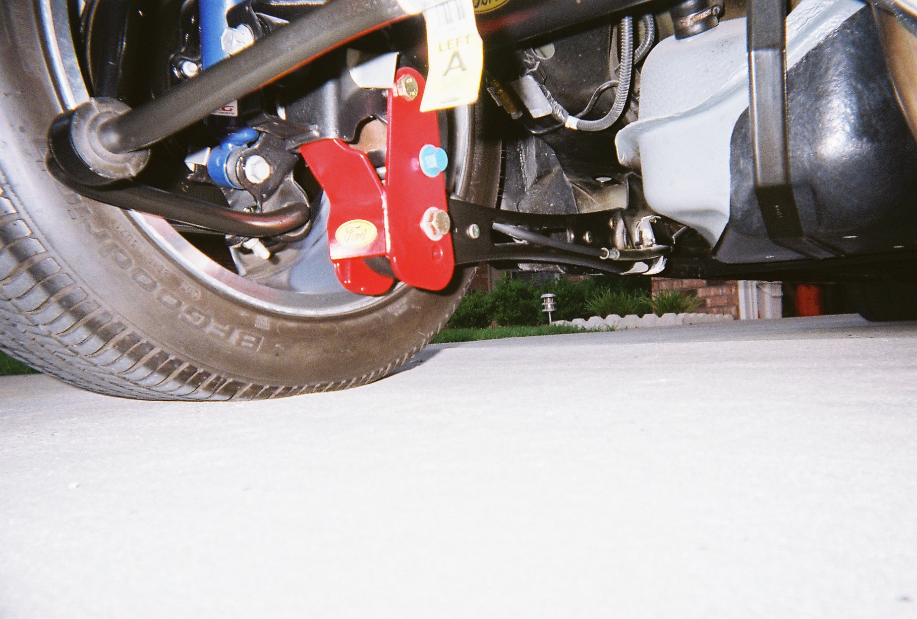

,,,respectfully in reply to your post ,,as you can see the ones on my car are made different than the ones in the picture you have posted and I feel that is a big differents in how they will work better ,Lower Control Arm Relocation Brackets.-049345-r1-10-15a.jpg

,,,respectfully"]http://www.moddedmustangs.com/forums/2005-2009/141937-bmr-lca-drop-bracket-heads-up-everyone.html#post2392789[/url]
,,,respectfully in reply to your post ,,as you can see the ones on my car are made different than the ones in the picture you have posted and I feel that is a big differents in how they will work better ,Attachment 76188[/quote],,PLEASE before you buy any brackets ,please notice the number of support " bolt " holes on each side of the brackets ,this is to keep the bracket from moving back and forth,,get it,,,the ones I have use all factory holes,,you will need four holes on each side of the bracket,,two of the holes are for the Control Arm .Lower Control Arm Relocation Brackets.-049345-r1-16-9a.jpg

OK, just to clear things up. We're talking about 3 different sourced LCA relocation brackets, BMR, CHE and the UMI brand that Rick has. The problem area appears to be the passenger side mount. The BMR brand only has one hole for the mount, one of two choices for the LCA and one on the tab that extends up to the axle mount. The UMI that Rick has have two holes for the mount which would appear to eliminate the possibility of the bracket being able to rotate and bend like the picture of the BMR that 06GT kindly provided the link for. However the CHE brackets appear to mount the same as the BMR in the links provided. So it would appear they would be subject to the same failure possibility as the BMR. From what I can tell by studying all these pics for the last 30 minutes is that the UMI brackets that Rick has mounted appear to be superior to both the CHE and BMR. Just my 2 cents.
