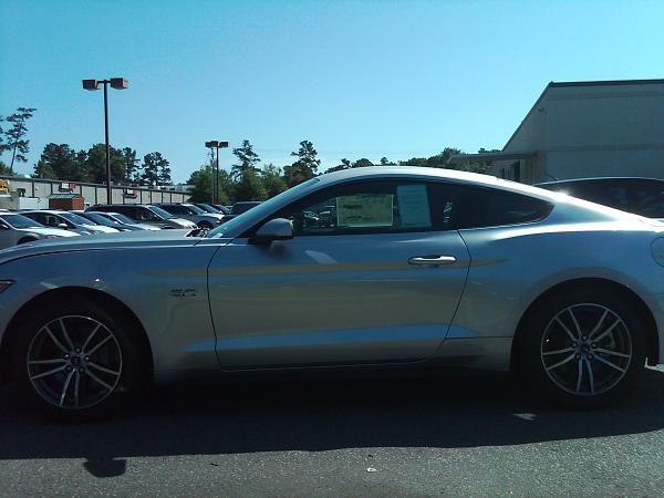

Just wanted to update my thread, I took my car into the dealership I originally bought my car from and had my sunshade fixed. They did a great job, if anyone in the Charleston SC area needs to have service work done I would strongly recommend Summerville Ford. While I was waiting I got a chance to drive a 15 GT and it was nice, Not nice enough to make me want another car payment, but nice.
Attached Thumbnails Sunshade on glass roof broke, need advice please-img01878-20150518-1009-15-gt.jpg
