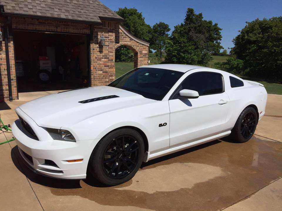

Okay I have a 2014 Mustang GT 5.0 Premium. I will have links to each added wheels and tires and info needed at the bottom of this post. I have 19'' american muscle rims.. 19x10 rear and 19x8.5 front. 285x35x19 Mickey Thompson street comps for the rear and 245s front. just michillens nothing special. A long with putting those on I added a Eibach Pro-Kit Springs - Coupe & Convertible.
Obviously its a lowering kit so my shocks and struts will not be in full affect and are already coiled so my ride is ridiculously rough. I am looking for the best thing to get to make my ride better and handling better. Right now when I hit a bump it feels like my car is going to explode.
Any information you need ask and I will find it. Will also post picture if I can figure out how. All links to items will be below this:
