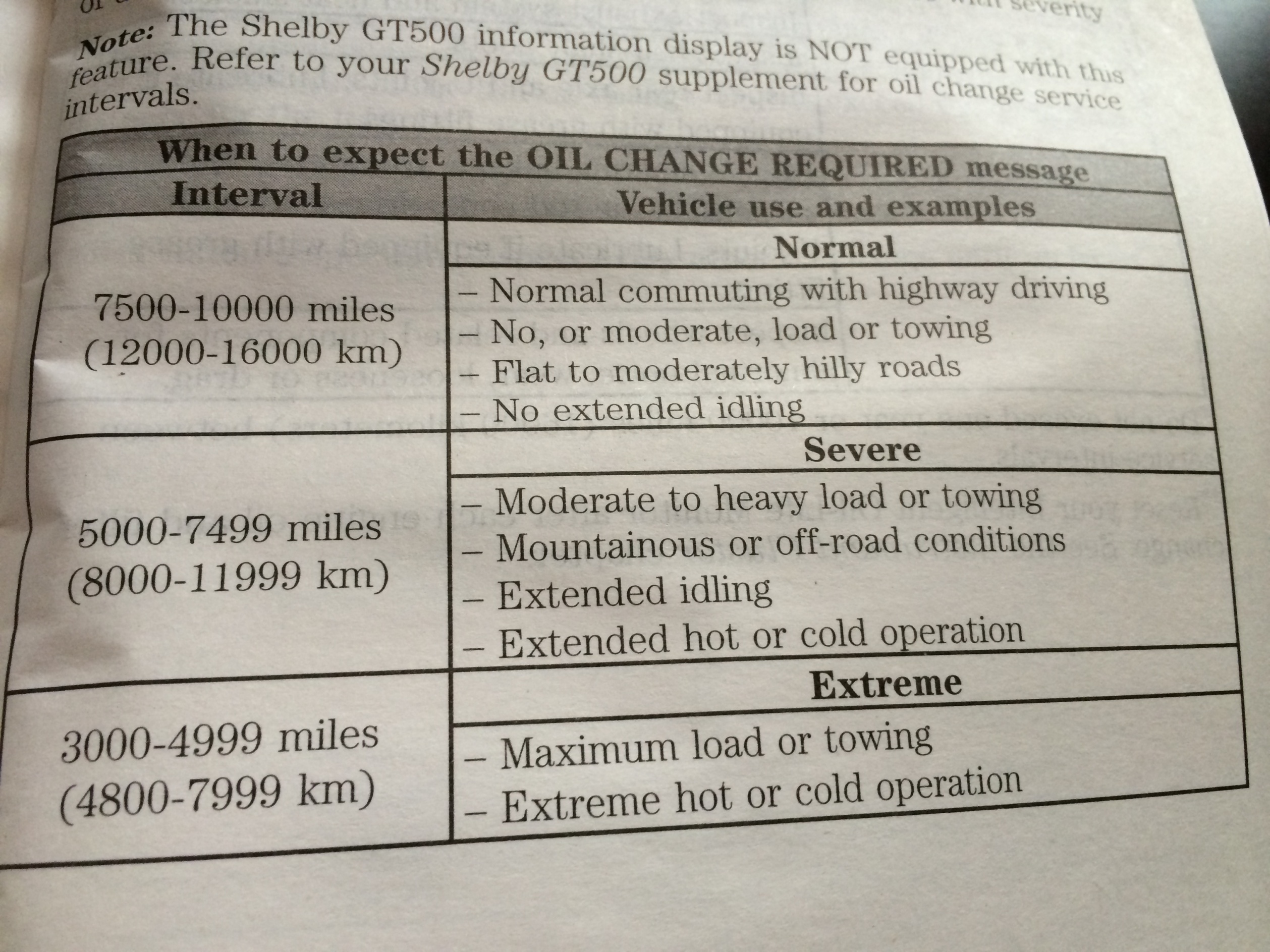

OK - this is answered.
the owners manual states that the vehicle is equipped with a oil-Life monitor which tells you when an oil change is required. i'm going to just go by that.
it also provides a table with examples. where I live, we don't have severe weather. its not like Winnipeg or Alberta

Originally Posted by JoeMidnight
OK - this is answered. the owners manual states that the vehicle is equipped with a oil-Life monitor which tells you when an oil change is required. i'm going to just go by that. it also provides a table with examples. where I live, we don't have severe weather. its not like Winnipeg or Alberta
Your warranty can't be voided by you only changing the oil when the car tells you to. That service guy is full of crap.

All good points and true!
I'm going to go by what the oil life monitor in the car says. I'll just change it when I have 5% left or when it says to. If I ever have a warranty issue where they challenge me, I will point them to the bible (owners manual)
