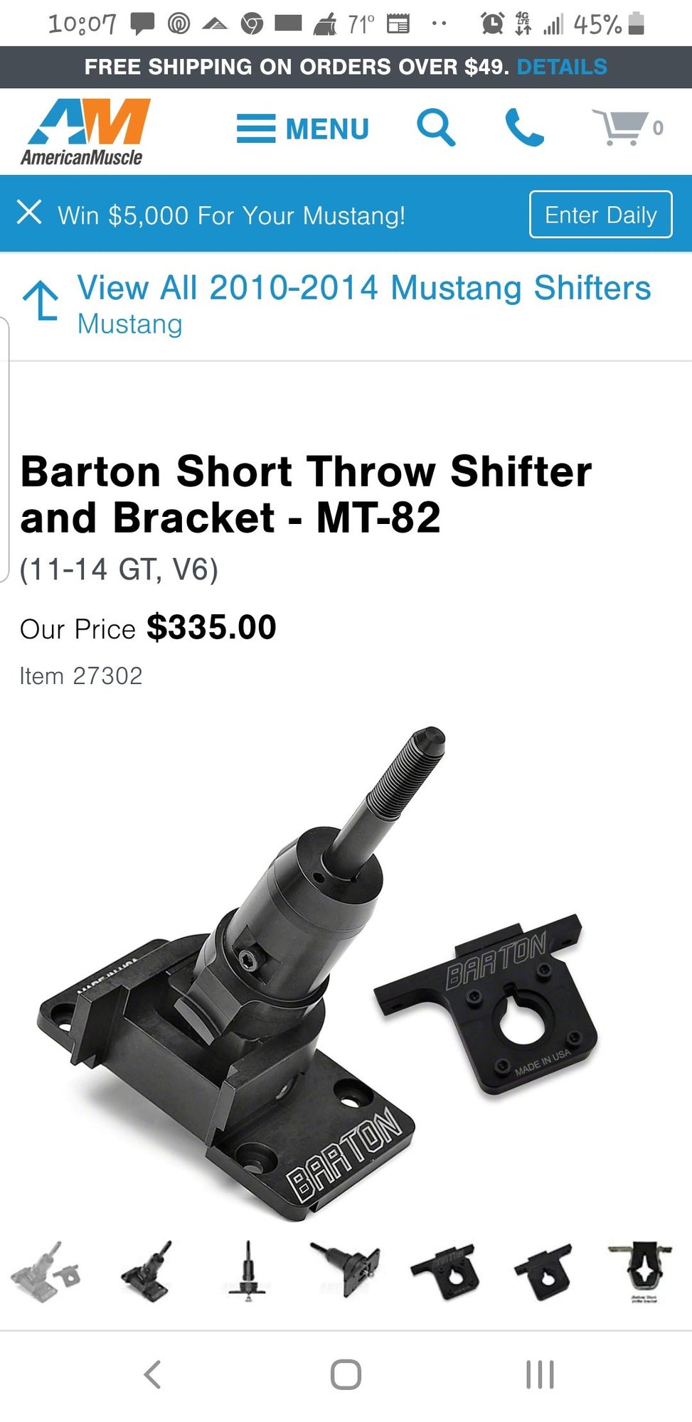

Oopps i meant the tranny additive. How do you adjust yhe shifter i have this one...

^ maybe so, but it would be easier to try the shifter first . . . I am pretty sure the Barton is adjustable, but I might be thinking of some of the other short-shifters since I don't have one myself . . . I would look for the installation manual, either on American Muscle (often available in the product listing) or direct from Barton via web site or phone

The new clutch will fix your dragging worn out clutch/throwout bearing. The shifter works fine, sounds like. You are not missing shifts, the issues sounds to be your clutch is not fully disengaging. Get that new clutch in there ASAP....
