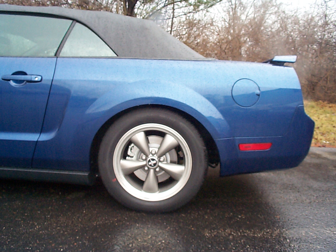

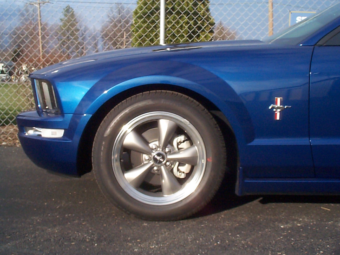

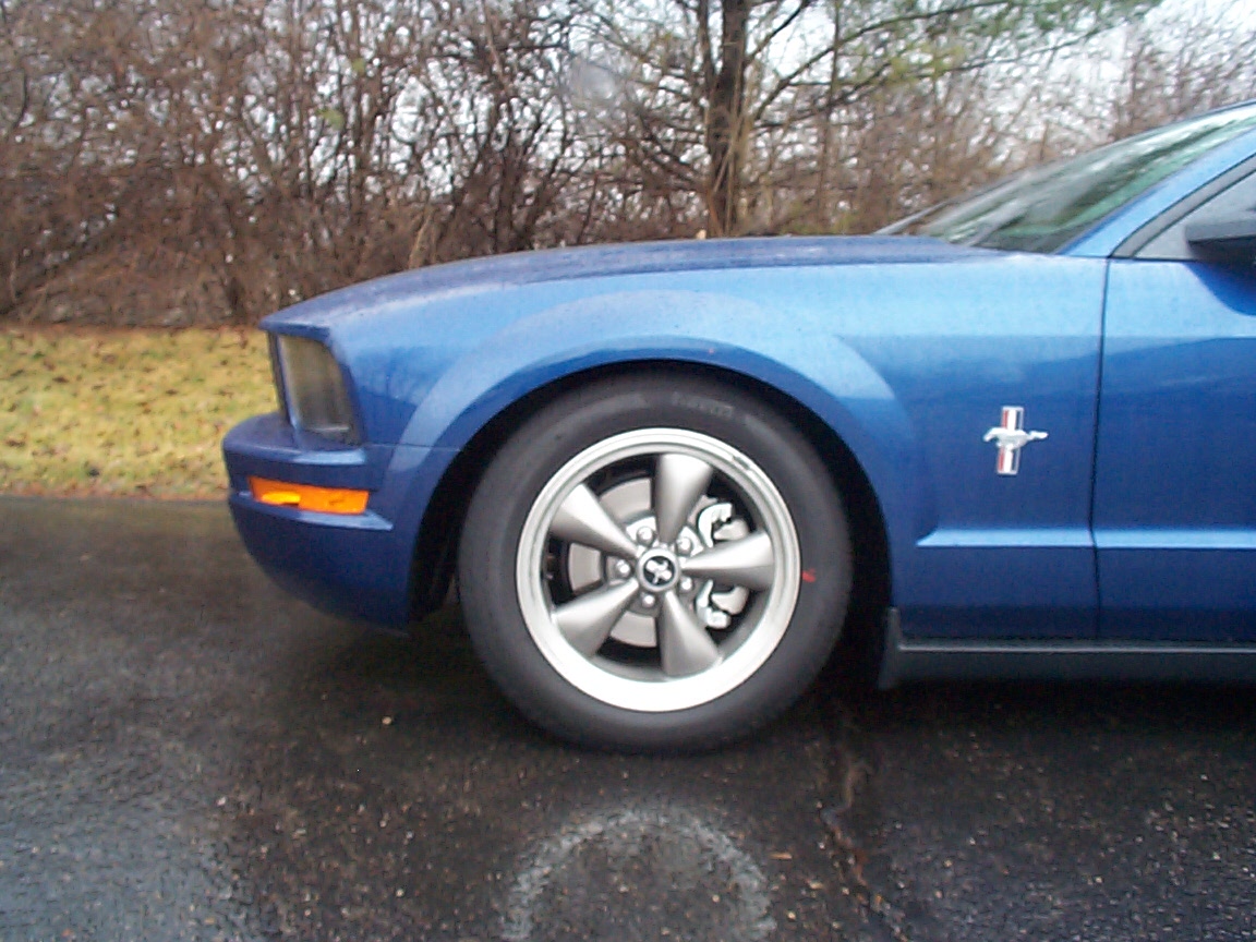

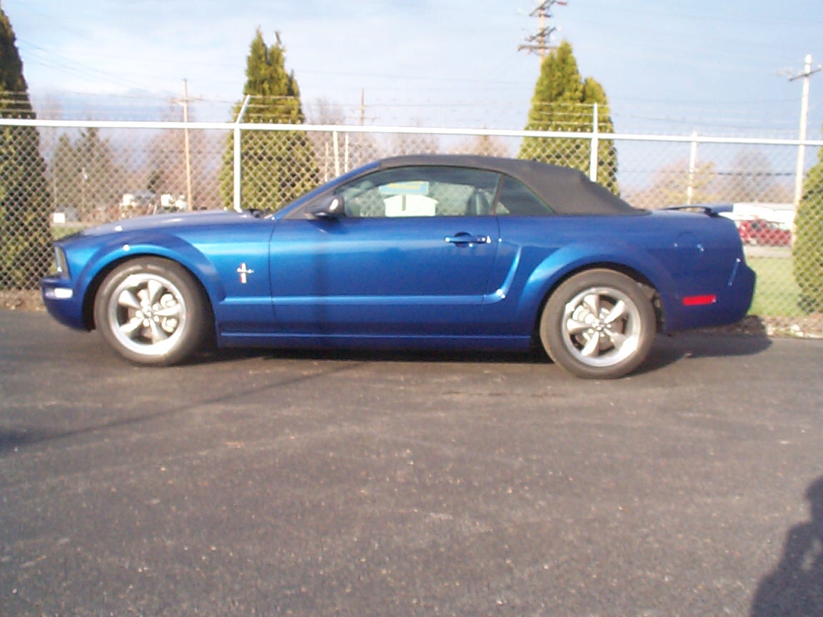

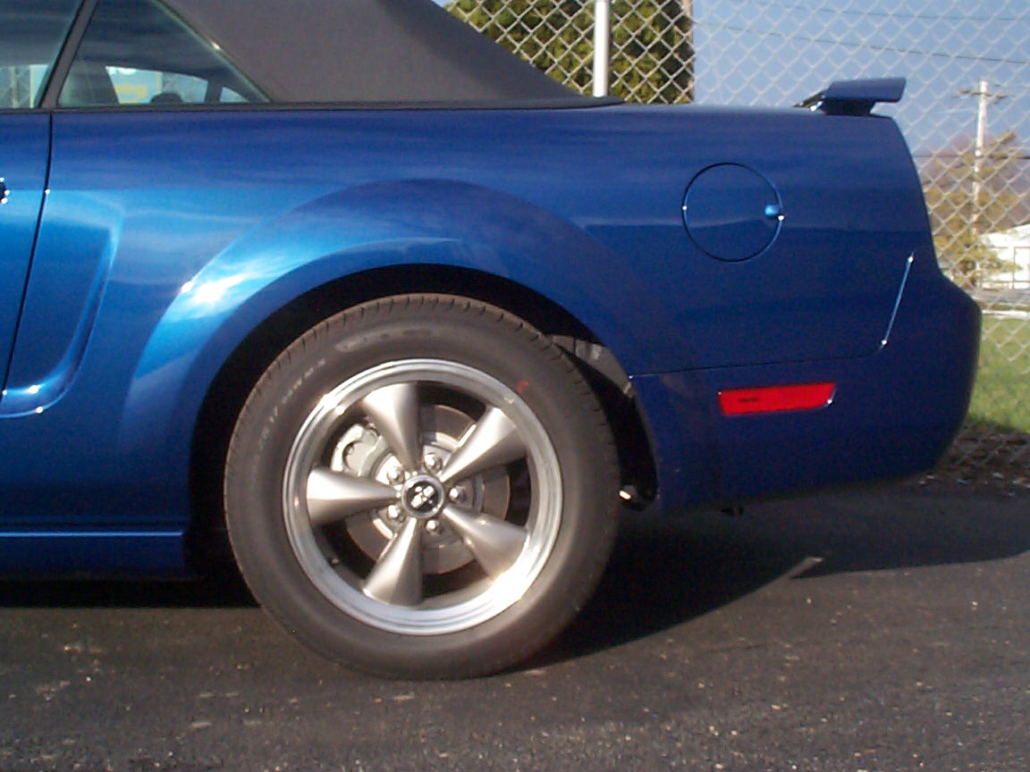

I had a 2006 convertible that I had Eibach sportline springs installed on, the drop was way too much, I ordered a set of steeda ultra-lite springs and installed them myself, I ended up removing the rear brace for the install so I could drop the rear axle. The rear brace is easy to remove. I was very happy with the ride quality and ride height. When I decided to lower my 2011 coupe I knew what springs I wanted and installed the ultra-lite. The first 2 pics are with the sportlines, the rest are the ultra-lites

The ultra-lites make that car look MUCH better. Never understood the desire to tuck the top of the wheel so far under the cowling. It makes the car look like a cheap, poorly-sprung ricer wannabe. People talk about the Mustang looking like a 4x4 if the front isn't half an inch above the pavement...never understood that.
Your car looks really good after the replacement.
