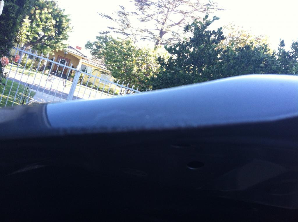

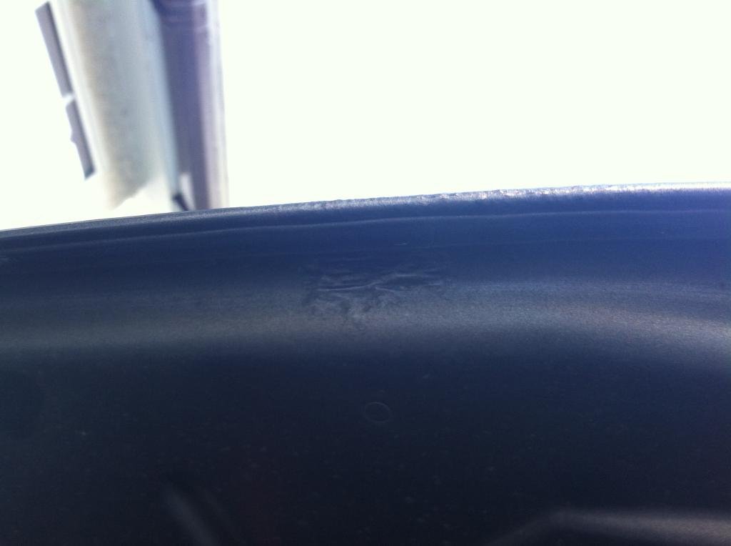

I had the same problem with my '11. Ford stripped the whole hood, and re-painted it. See pictures below for damage.
