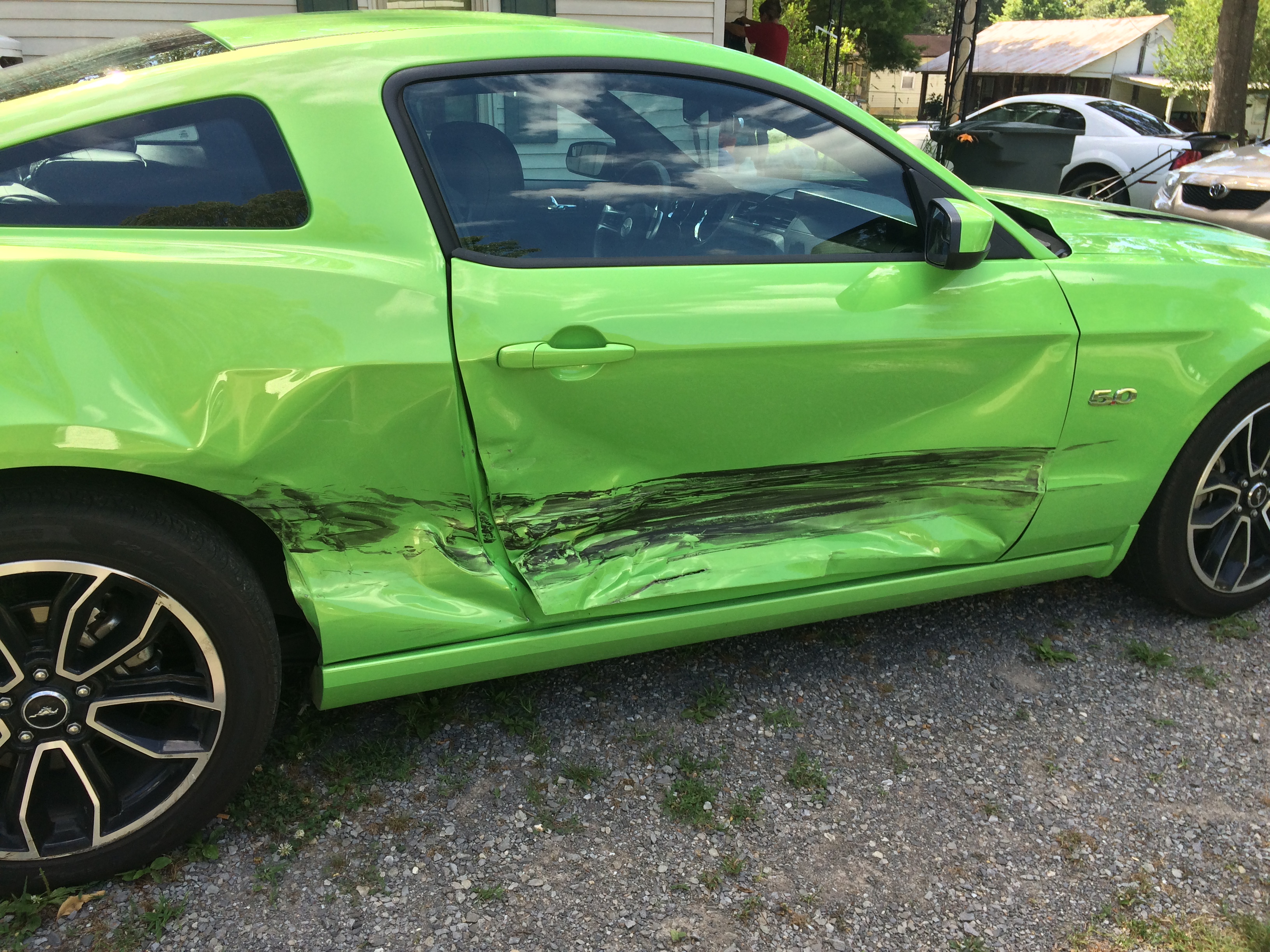

what do y'all think? car hit me today
Attached Thumbnails do y'all think she totaled-img_1258.jpg   do y'all think she totaled-img_1256.jpg   do y'all think she totaled-img_1255.jpg

****! I feel for ya. I really dont know, theres a lot of bodywork to do and you dont know what might have happened underneath.

No, you're not totaled. The left quarter appears repairable. Not so the r/s quarter. You have some structural damage in as much as a welded panel that requires replacement is considered to be structural, but it's nothing that can't be corrected. Most auto damage these days involve some level of structural damage, but based on area of the impact it's typical and not severe. I'm not sure if the Mustang has both an outer wheelhouse and an inner quarter panel, but if so you might need at least a new outer wheelhouse...and certainly a door. You'll need a new lock pillar but that might be part of the new quarter assembly. The r/s fender appears minor as does the right rear wheel.
I wouldn't be fearful about a repair....it's relatively straight forward. Even the paint might not be as much as a problem as you might think. There'll be some blending involved no doubt. I wouldn't worry too much about that. Our Mustangs have some very sharp and defined body contours. Most of the painting will be on the sides. Much of the blending will be on the tops of panels. Paint appears different in sunlight on different angles anyway, so a good painter will use that to his advantage when blending into the same panels and even adjacent panels.
Just based on the photos you provided, it looks worse than it really is. A quarter replacement is a very common repair.
Good luck and keep us in the loop.

Ultimately it's an insurance company's decision on whether a car should be repaired or totaled. Each company has it's own parameters, but generally speaking a safe assumption would be 80% to value, i.e when damages approach, reach, or exceed 80% of the vehicle's value, a car will be declared a total loss. But every case is based on it's own merits. I've made decisions to total cars at 60%, and sometimes I've totaled a car at 95%.
Not knowing any of the factors that would impact YepItsGreen's GT...is it a 2013 or 2014...GT Base or Premium...mileage/options...let's just assume that the value of this car is at least $25,000. Also let's play it close to the vest and also assume that it's his insurance company's policy to total a car at 75%. That means there'd have to be almost $19,000 in damage to the car.
It's not possible to estimate his damages without physically inspecting the car, but I certainly don't see anywhere close to $19K. Based just on the photos he provided, it appears to be a very repairable impact. It's been a while since I had access to crash estimating tools and parts prices (I'm retired), nor do I know what the labor rates are in his state, but if I had to throw a dart at a board I'd say this might be in the $8K range in damages. That's just a guess though.
