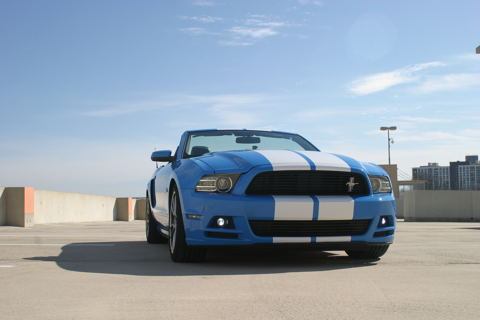

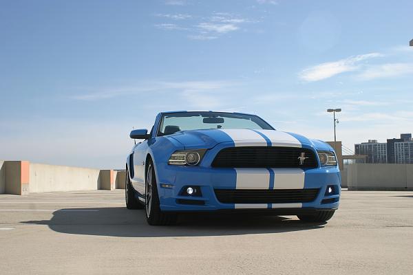

unless you are all squirrels you pretty much need to shut up with this unfounded belief that somehow properly aimed projectors are going to glare. Case in point... you're being blinded BY stock headlights in the slock location at the stock height for the headlights as well as the fogs, a foot off the ground. Secondly they're projectors they're made to not glare like halogens.. To prove a point, tell me how blinded you are by essentially the same shot but about a foot higher off the ground.
Attached Thumbnails Converting the LED fogs to HID on a 2014-8461652093_b5081dfe3d_o.jpg
