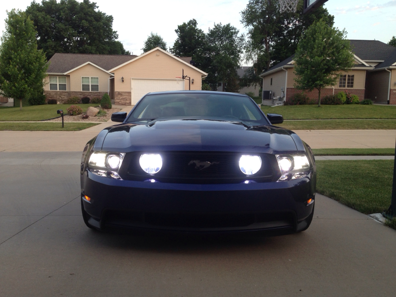

I'm just going to leave this here.

A perfect example of annoying glare from HID conversions.

except this was ground level. i blind squirrels.
So are those just Led H11 bulbs?
Old Nov 8, 2013 | 04:23 AM
Likes: 173
No I think she has an actual hid conversion kit, complete with ballast of course. Diva, correct me if I'm wrong.
I just have the LEDs...
