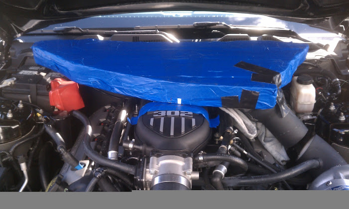

I am also working on an air intake system for the procharged cars. I do like how they run but hate where they pull the air from. The main reason Joe bought the HO Fibertrends cowl hood was because I wanted to work on a cowl fed intake for the prochager. I took some time today to get a basic shape outlined in foam. I'll probably make the first one out of metal but would like to make one out of carbon. With the hood closed, the procharger will pull all its air from the cowl only. This is a high pressure area and is a perfect place to pull air from.
