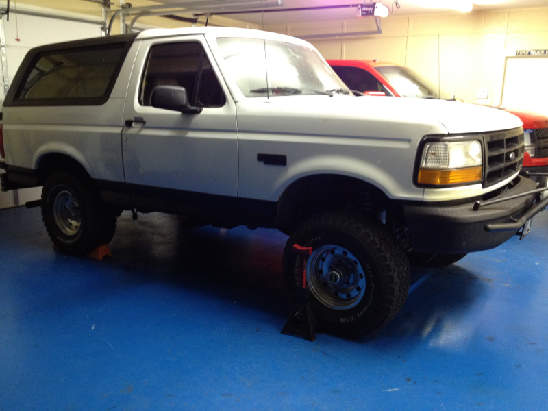

Bronco update...
4" front lift is on. Haven't touched the back yet.

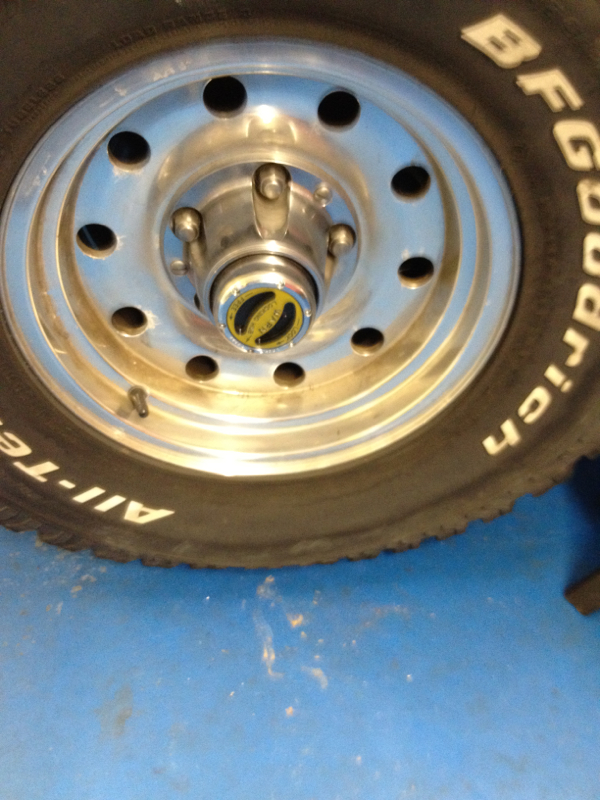

New Warn manual hubs...

Well its still not on the road yet. I got the lift kit completely installed. Looks awesome now. But my one CEL is the CPS or crank position sensor. So I did a little research and here's the issue. My harmonic balancer was thrown so to speak and the rubber that attaches the outer imbalance ring to the inner part that mount on the snout was cracked and stuff. As a matter of fact the two pieces separated almost completely when I removed it from the old motor. So I needed a replacement. OK fine got online and ordered one from Rock Auto weeks ago and installed it. Well I knew when I was putting it on that it was wrong. And should have stopped there. This was the one item in the whole engine reinstall that didn't go exactly like it should. From 1981-1995 Ford made a balancer for the 351w exactly like the replacement part I got. But the problem is in 1996 the balancer was different. And it was different in 1996 only. There was an extra skirt or so behind the balancer for a factory installed tone ring for the crank position sensor (misfire sensor) Ford decided to mount down on the timing cover aimed at the toner ring behind the balancer. MAybe it was for OBD-II or who knows why but this was the only year they did it. OBD-II came into effect in 1996 and by 1997 the Bronco was gone and the F-150s were getting 4.6 and 5.4 engines.
So using the Bronco forums I've tracked down a guy in California or Oregon I don't know which honestly and he will rebuild the original balancer. That's the only solution. He might have one that's ready to go, otherwise I'm gonna have to send mine in to get it redone, or pull one from junkyard from a '96 F series truck or E series van or Bronco of course.
