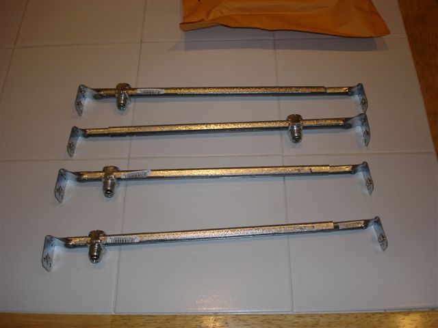

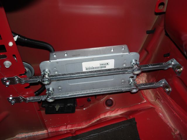

Alternate method of securing Sirius DLR in trunk
I'm in the process of installing Sirus in my wife's 06 stang. Her 06 was built around July 06, so the areas in the trunk, where the Sirius control unit (a/k/a Sirius DLP) mounts, as well as the area where factory antenna mounts, is exactly like an 07, which makes everything a little easier. Only problem was, that KC (at Clevenger) said the factory bracket for mounting the DLP was on backorder and he had no idea when it would become available, so I had to find an alternate way of mounting the DLP.
Here's how I did it..
I purchased 4 Adjustable Arm Brackets from Home Depot, in the Electrical area. They cost me $10. I only need to install two brackets, however, you need the extra two brackets for extra parts. Following is a picture of the four brackets purchased, and a final picture of the DLP securely installed. Plus a picture of the underside of the trunk lid, showing where I installed the factory Sirius antenna. If anyone is interested, I will post more details. All I need to do now is install the new harness, which includes R & R the Shaker 500 Head Unit. So far, this has been fun.
Attached Thumbnails SIRIUS PLUG AND PLAY FOR 05 up Mustang-dsc02905.jpg   SIRIUS PLUG AND PLAY FOR 05 up Mustang-dsc02917.jpg   SIRIUS PLUG AND PLAY FOR 05 up Mustang-dsc02919.jpg

Factory Sirius Install Complete!
I finally finished the install. Yesterday, I pulled the radio and connected the harness, but just left the part of the harness that goes to the Sirius DLP in the trunk coiled up under the dash near the fuse box. Today, I did the final part, running the harness back to the trunk area and plugging it into the Sirius DLP. The last part took only about 45 mins, which included removing the panel covering the fusebox, the sillplate, bottom rear seat cushion, rt. rear inside panel, which made it so easy to piggyback onto the existing harness with tie-wraps, all the way to the trunk. After plugging it into the Sirius DLP, I just turned on the radio and pressed the AUX button, now I have factory Sirius! I purchased my Sirius DLP on ebay from a guy who pulled it out of his new 07 F150, so it still has at least 3 months of free Sirius subscription. Now I have to decide what type of subscription will be best for me, the month to month or the lifetime. In case you're wondering, I bought everything ala cart, including DLP from ebay, Bracket hardware from Home Depot, Visteon harness from Anco Auto Specialties, Factory Sirius Antenna & extension from KC at Clevenger. In total, I spent $325, including shipping costs. The install was really easy and fun, thanks to Sodaman's great write-ups and pictures.

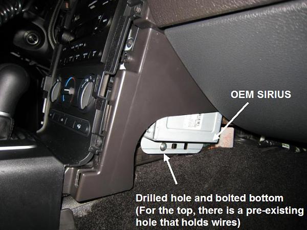

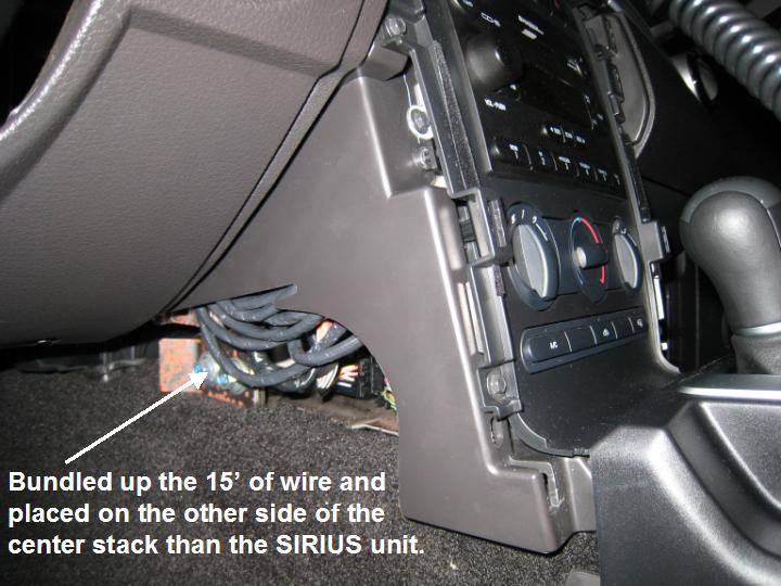

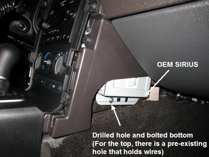

Originally Posted by GTEUPP
Here's an alternative mounting location which worked well for me. There's just enough space to the right of the OEM radio mount bracket and the left passenger kickplate panel to mount the tuner in a vertical orientation...
Just got my SIRIUS unit from KC last night (Thanks KC, you rule!) and did the install the same as GTEUPP! Great idea, GTEUPP! As for the 15 ft of cable, I wound it up with zip ties then put it in the void on the left side of the head unit (same place as the SIRIUS just on the other side) and zip tied it up top so it wouldn't shift. It just wasn't working for me to ball it up behind the A/C controls. My rule of thumb is that if you have to force it, you shouldn't be doing it. Anyway.. it's not the factory install but it's neat.

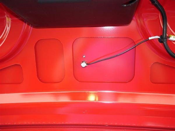

Hey can you all tell me where does the factory Sirius antena mount? I dont quite see that, does it mount under the trunk lid or where? I have not seen a new Mustang with the factory Sirius install yet so I'm trying to understand where the antena mounts, I'm going to be ordering my Sirius factory package from KC soon , so I'm trying to understand how it all mounts.

Tim, for a clean look I suggest one of the 3 following options;
Option #1 factory install:
If you’re trying to do a factory installation, you’ll need to pop a whole in the top of the trunk and ask KC specifically for the OEM factory antenna (it’s different than what normally comes with the SIRIUS unit). See sodaman’s posts for pics:
