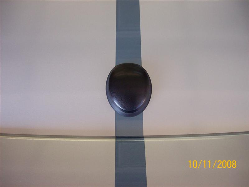

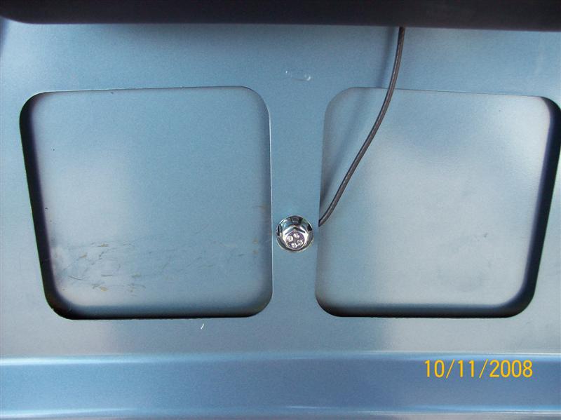

I finished the antenna installation today. Went ok. I had already drilled a hole about 8" from the front of the trunk lid/glass area in the center. I already have stripes so a little bit easier to find center than those that arent already striped. I used a unibit that goes up in sizes to drill the hole. It was on the 5/8" step when I slowed down. I then had to drill the smaller placement peg hole I dont remember what size that was but pretty small you can eye it up easily. I placed the antenna in the big hole with a little bit of touch up paint on the little peg to get a mark for where to drill the next hole. Once I got that I center punched and drilled the second smaller hole. Like I stated in my previous posting the 07 has no crossmember in the way for the antenna install, but my 06 does have a center small beam. I unfortunately ending up having to cut it. First I drilled it the same size as the big hole in the lid itself. But there is a clamp that bolts down from the trunk side that wont fit through, So I had to cut out a small section. I don't think it will harm anything. I applied a small bead of silicon around on the bottom of the rubberpad and popped the antenna through the hole, then applied the bolt and clamp from the other side and tightened slowly until nice and tight and the plastic clips on the antenna have popped up after going through the hole. You will understand what I am saying when you do it. Wallah, second part done. Third and final step is the wiring harness, probably wont get that done today. Will follow up with new pics as avalable, here are a few.
It is possible to install the factory installed Sirius antenna on an early style trunk lid without cutting the brace but it is very time consuming and care must be taken to correctly position the holes. I used a unibit.
Can anyone provide me the part number of the antenna extension harness?

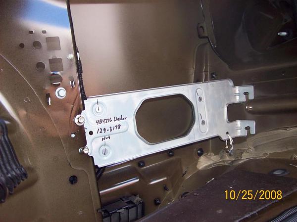

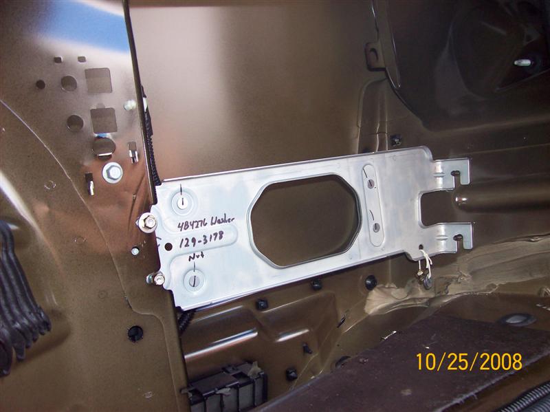

I am installing one of Kevin's Sirius kits in my 05 GT which has a Shaker 1000 but no provision to mount the factory mtg bracket for the Sirius DLP. Fortunately my wife's 06 GT which has a Shaker 500 is already set up with the mounting studs and holes already drilled in the body from the factory. I snapped some pictures and took some dimensions. Just an FYI, if you have a Shaker 1000, the OEM bracket w/DLP mounts behind the amps. The subwoofer enclosure and amps w/mtg bracket must be removed to gain access to this area.
