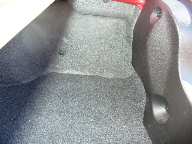

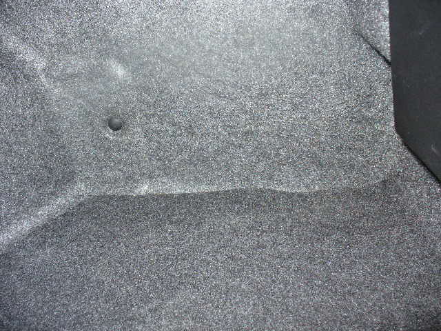

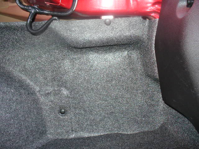

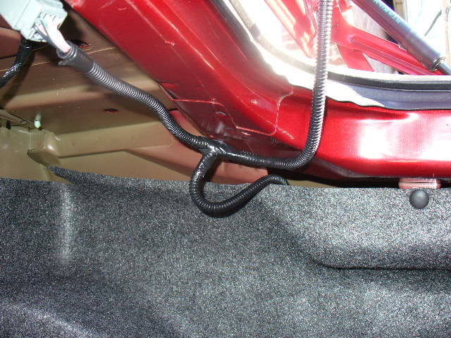

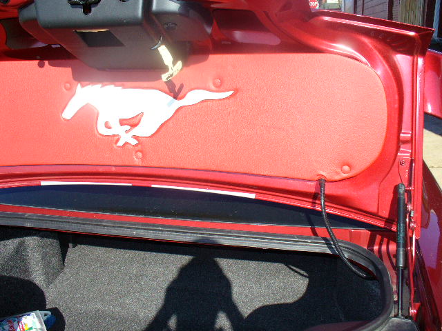

Alright the installation is finished. I am very pleased with the factory install after the factory that is, LOL. I think I came as close as your going to get. I got the last pieces I needed from KC, the antenna extension wire for factory antenna, and the new grey panel insert for the trunk, as the satellite reciever takes up the space the old insert went into. I had to trim the bottom piece that covers the spare as it is designed to go into the cubby hole as well. That was a breeze, just used a straight edge and cut with a razor. Turned out perfect. I did use the factory conduit that is already coming from the trunk lid. I just undid the snap ins and the electric tape and pushed in the new wiring into the conduit. There was exactly enough space left. I then retaped the conduit like factory and added a few extra just for good measure. I followed the conduit all the way down to the sirius receiver area then I finished it off with tie straps. There are a few snap in areas you have to undo the tape to continue in the conduit, so just have some electric tape ready to go and all is good. I am very impressed, this looks exactly like factory, but even better with a trunk lid cover, as you cant see the antenna or wiring at all from the trunk. If you are going to do the factory antenna location you will need a trunk lid cover or organizer from cdc would work too. Hope all this helps. You can get an awesome install I think if you take your time. Good luck to all. KC is the man, thanks for coming through with all the diff parts KC. Ill chat at you soon, now lets go rock the SIRIUS, seriously, LOL.

Looks great, sodaman Very clean install.
I finished mine last night. Big thanks to KC for all his help. I bolted mine at an angle behind the wheel well frame and reused the same trunk insert. It wasn't the best solution, but it works for me.
