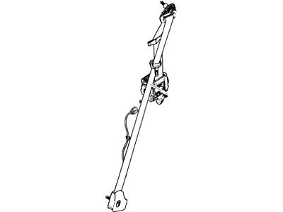

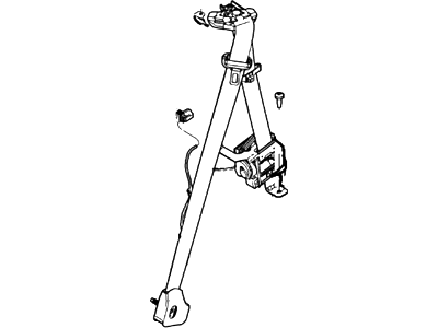

However Here Are the Parts Pics!
Individual Components!
FYI, Ford Changed The Thread Pitch on Some of The Belt Mounting Hardware in 08 So Be Advised If Using Later Belts! They Are Self Retained & Not Fun To Swap!
https://www.fordpartsgiant.com/parts...eat_belts.html
KC
Coupe
Coupe
Vert
Vert

I Went to 09 & Got A Vert Pic!
Guess it Took Them a Few Years To Figure Out it Was Missing. Also Note Different Style Coupe Attachment!
I Dropped Back to 05 And It is There as Well! I Guess 06 Was Just Left Out For Vert in Shop Manual!
In 05 Had Two Separate Sections For Coupe & Vert, 06 Did Not Have Vert and 09 Combines Both in One Section! AYE CARUMBA!
