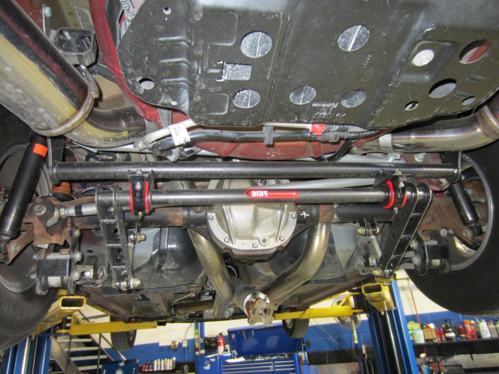

Originally Posted by Scott2
BMR Anti-Roll Bar.
So why are you running the Steeda bar instead of this? How is the BMR unit on the street? I understand some even unhook it for the street.
Differential needs to be in the car to weld the Anti-Roll Bar tabs on it. I built a new diff out of the car and when I installed it used a sway bar I already had. Have purchased four new tabs and will weld them on one of these days. With both anti-roll bar links attached the ride can be pretty rough as you feel every bump. I understand some people disconnect one of the links for street use.
This picture shows the tabs I am talking bout on my old diff.
