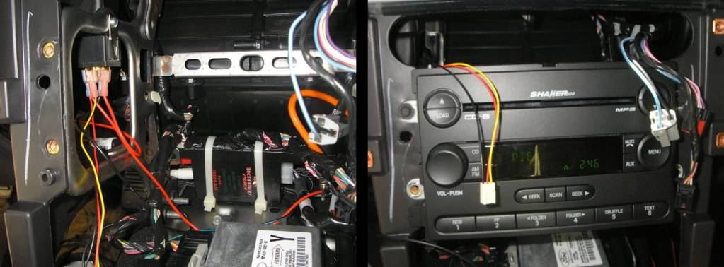

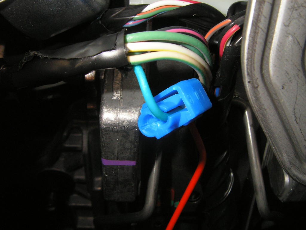

OK, I finished. Wasn't very difficult. I did everthing like John and Dustin said. I wired it to the number 5 slot in the fuse box.
Here is a pic where I tapped into the starter wire.
Attachment 340
I really liked the wiring harness that came with the S2000 button that I got from here:
EBay S2000 Start Button
This is a pic of where I mounted the relay and a pic of the harness before I installed the button.
Attachment 341

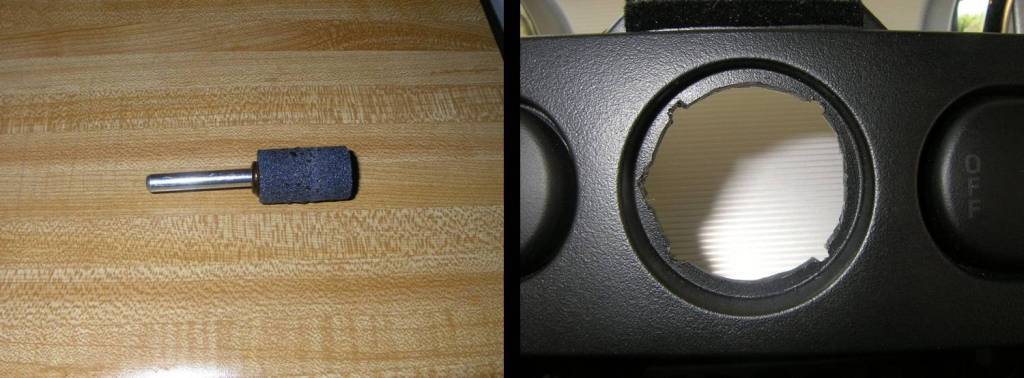

I don't have a Dremel, but I bought this at Home Depot and it worked perfect with my drill to make the hole a little bigger. That along with my xacto knife I was able to get the hole right in about 20 minutes.
Attachment 342

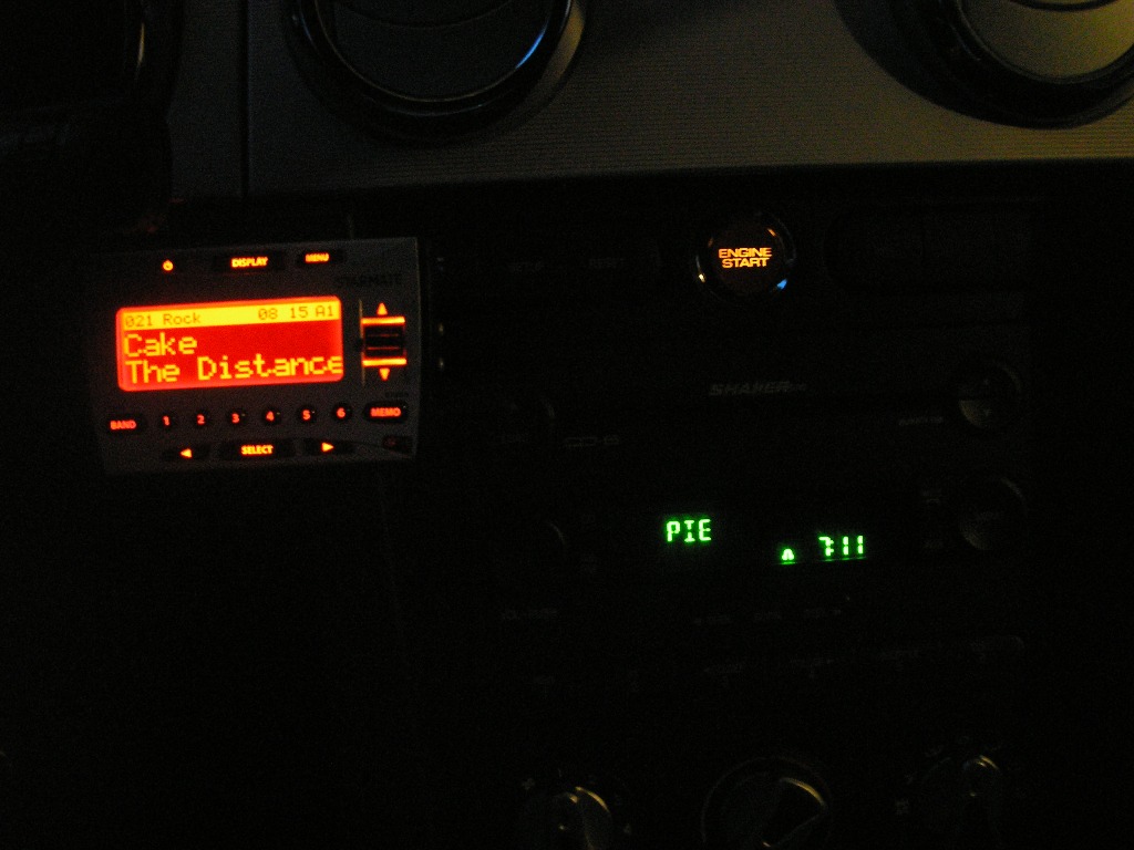

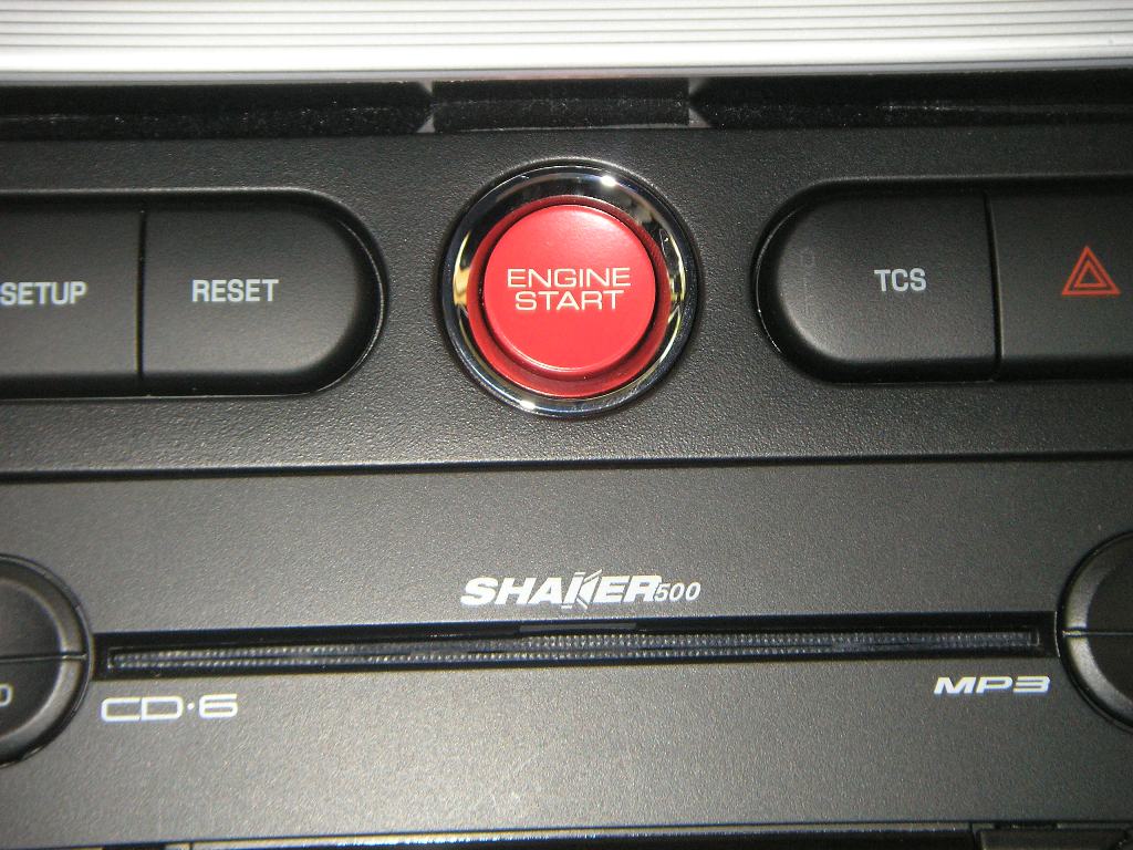

The finished product.
Attachment 343
And in the dark.
Attachment 344
