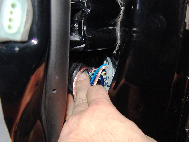

It can be done. I managed to install some Boston components in a friend's car using 12 gauge speaker wire through the door grommets.
I would estimate it took me 8-10 hours to do. If I had to do it again it would take two or three. My back hurt for weeks and my hands were badly cut up. Never again.
You can actually slip the speaker wire just underneath the clip (see attached photo). Let me know if you really want to attempt this and I will do a write-up.
Tim
I'm sure there's ways to do it, but I don't care for it. I shipped back the component system long ago, and just used regular Polk's for the front and rear.
