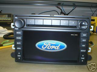

The nav that does go in our cars:
uses a nav disk
has satelite radio
audio input
navigation
radio
6 CD player.
The Escape nav has all that plus:
10 gig hard drive
Travel Link
3D mapping with icons
Fuel pricing
movie listings
sports updates
weather mapping and 7 day forecast
customizable sreen savers
SYNC compatible
Blue Tooth (I think - it has phone functions)
buttons glow light blue - not puke green as in our cars.
I am selling mine now, as I do not want to be the pioneer in figuring out how to program it. If someone else gets it working, I may try this again.

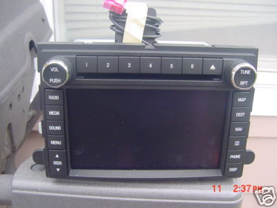

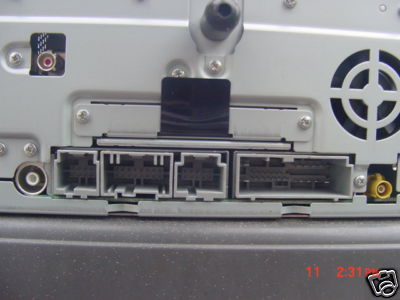

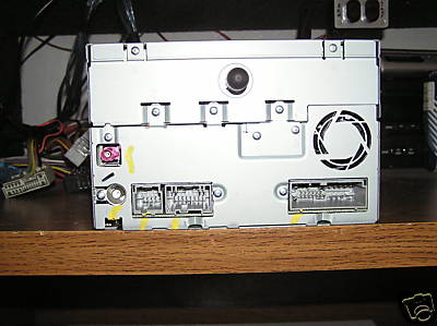

From a programming point of view, I can't say, but physically they are different front and back.
The 1st 2 are the 05 - 08 nav, while the 2nd 2 is the 09 nav available in the 09 Escape and other 09 vehicles (except Mustang!):

Posts: 10
Javier,
Thanks for the photos showing the differences between the 05-07 Nav and the 09 Nav. Does anyone know if there is any functional difference between the 05-07 nav and the '08 nav? From what I can tell there are a couple physical differences. the ***** have a silver trim piece and the mute button on the left hand side is replaced with a phone button. Does this unit have built-in Bluetooth capabilities for your phone? Or did they just change the buttons since SYNC was released in 2008 on some vehicles?
