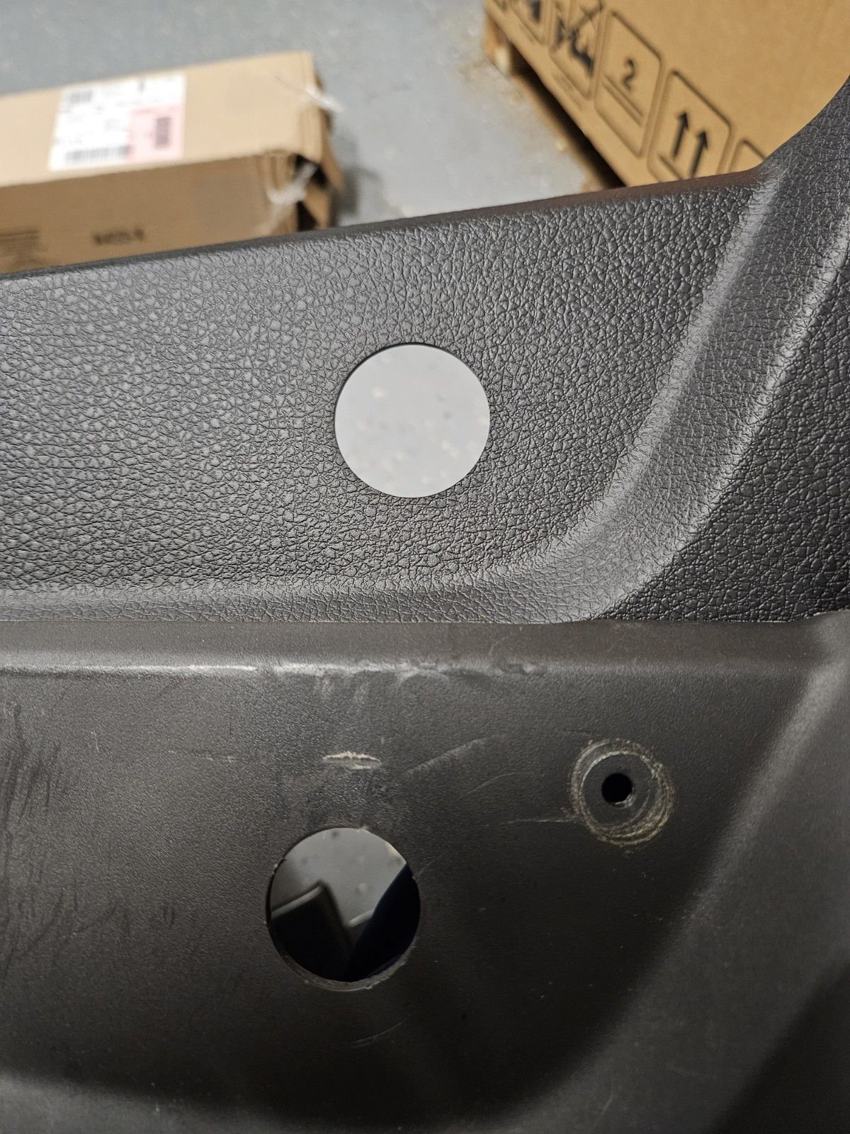

Note,
Come To Find Out The 05 Button Style Is a Different Texture Than 06 Up Style. Still a Decent Match!
This One Is Going To Get a Button Transplant!

Awesome observation on the texture differences, Kevin

Thanks For The Credit But a New Friend I Made on Ebay During a Message Center Switch Purchase Had Later Needed a Sight Shield and Asked For Some Help. After a Phone Call He Went With Later Shield I Suggested Button Retrofit. He Sent Pic After He Got New Shield. The Full Circle Effect! I Suggest Pop Rivet & Epoxy For Button Attachment. We Shall See!

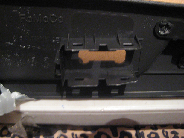

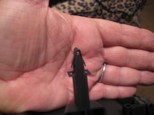

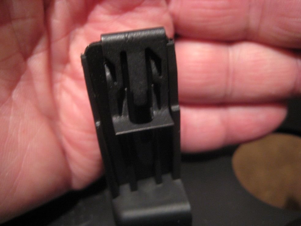

Those Metal Clips GRIP Like The Dickens! Simply Pulling The Covers Off May Break Your Panel. The Clips Need To Be Pinched To Release. FORD Even Says Upon Removal To Replace Panel. So Be Advised. You May Have To Remove Seat to get Good Access! You May Figure Work Around But it Always Helps To See What You are Fighting!
2 Small Pics From My Replacement!
Other 2 Pics Show How Switches are Retained!

Thanks KC, I have seen those type clips before...they actually rip the plastic off/out when attempting to remove....let me think about this one... ....BTW, I just saw the video on the first post...makes me wonder why Ford made this part so difficult to replace...ha...
