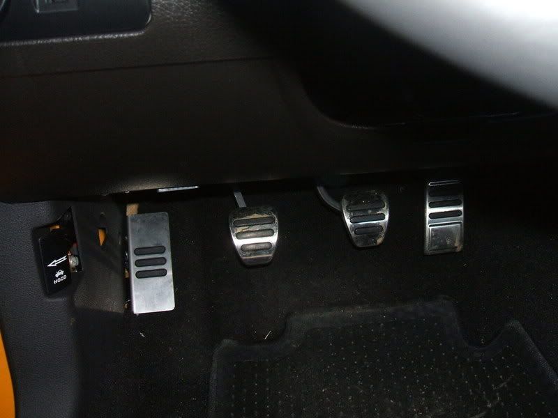

To all those installing these pedals, please be careful when installing them. When I installed mine from CDC I found that I had to force it against the wiring bundle that runs along the floor. That made me a little nervous, as I was afraid that over time the edge of the pedal might wear through (because of vehicle vibration) the insulating material and possibly cause a short or worse yet a fire. So to prevent this from happening I wrapped the offending metal edge with rubberized electrical tape before installing it. This post is in no way a slam or flame of CDC or any other company that makes or distributes this item, this is purely an observation on my part of a possible long-term problem.
Having said this I am very happy with the results, the pedal looks stock and has minimal flex.

pics??

Boltzman:
Ignore the dirt.

Thanks
