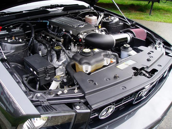

I successfully installed a V6 Pony Grill/Lamps in my 07 GT recently. I can be done with a minimum of fabrication and in about an hour's time with basic hand tools. The wiring harnesses are the same, so it's plug and play...
http://forums.bradbarnett.net/showthread.php?t=73950

Here's a close up under the hood, so you can see that it all looks factory. Brackets are hidden from view under the radiator cover. Simple swap with just a minimum of fabrication....
