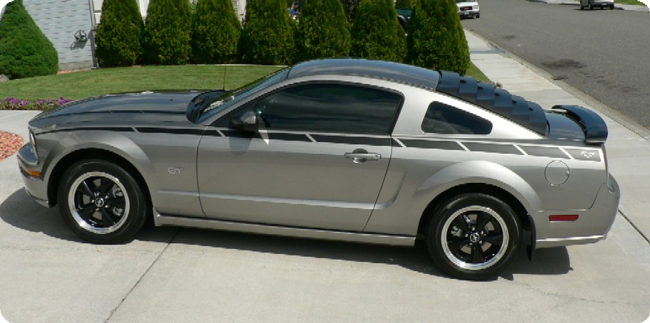

Here's what the car looks lke now. doesn't it need black emblems?
