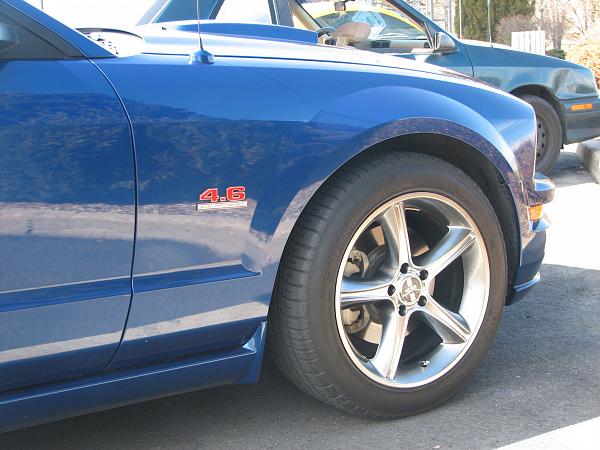

I replaced my GT badges 4.6 High Performance badges and covered the holes with no problem, You could get some 4.0 high Performance badges they would look great IMO

Oh nice! Thank you SoCal and Steve! I may end up doing this after all!!
PS - is it hard to remove the stock emblems? What is the best method? I was thinking bout just trying force and lots of Goo Gone?

Luke its real easy,Hair drier and out in the sun for a while helps too and some 10 lb fishing line run behind the badge after its warm enough, most of the adhesive came off with the badge I just used some WD40 to clean off the rest of the adhesive and all was good, cleaned with some alcohol and ready to install new badges.
