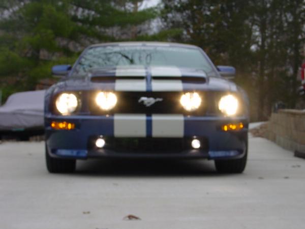

Just got done installing a set of PIAA fogs in the lower grill of my GT/CS
Still have to wire it up, but this was the hard part finding all the tools to get it done.

it was fairly easy, just cut two pieces of 1/8 alum about 2" x 6", angled one corner about an inch and drilled a 1/4" hole which mounted over one of the bumper extention mounts. Had to get the nuts from the dealer body shop ( parts has no clue what I was talking about ) Cut a 2 1/2" hole in the side grills. Bent the alum to get the right angle. Mounted the lights to the alum and bolted them to the bumper mount.
My hard part was getting with a friend who had some scrap alum, another friend who had the hole saw and going to two auto parts stores to find the nuts. also crawling under the car about 20 times

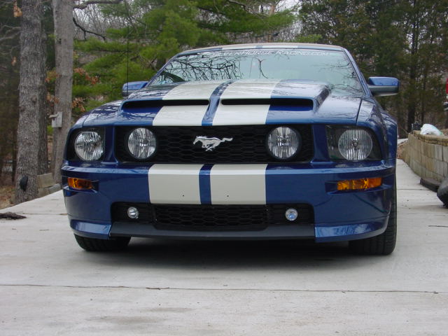

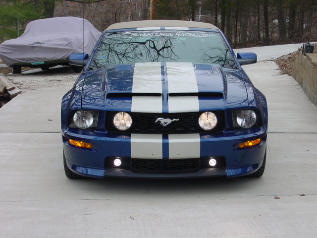

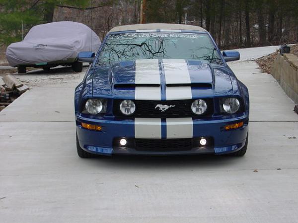

finally got the fogs wired and working, here are a few shots.
Fogs only..............................Fogs and Fogs..........................All at once
