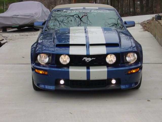

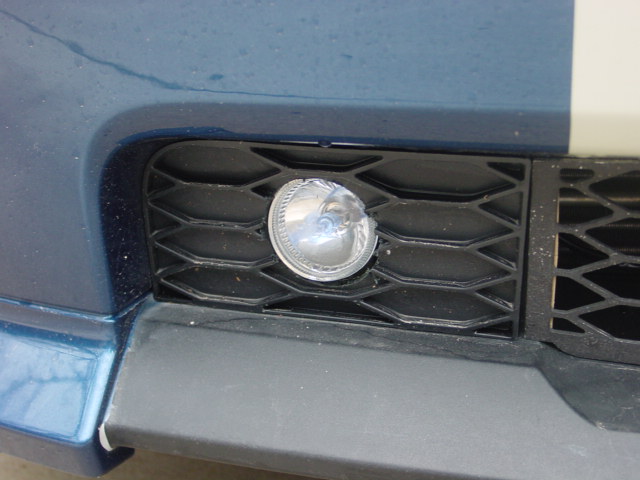

unless you really want the brake cooling part, here is an eaiser and cheaper way. Just get the PIAA lights, drill a 2 1/2 hole on each side and wire them up. Will get some closer pix later.

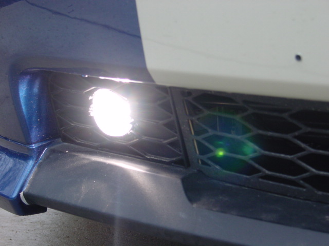

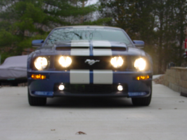

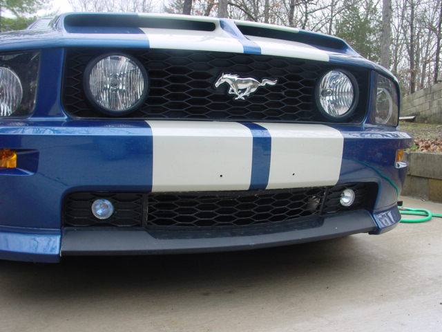

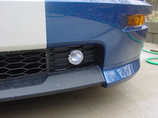

here are some more:

Where did you get the grill insert for the center part of the GT/CS fascia? I like the PIAA's a lot. Very nice work.

looks sweet. How hard was it to wire them up?

Those pics look great. I'm really starting to like the PIAA fogs.

got some plate alum from a friend and bent it to fit, drilled a hole and mounted it to the bumper extention stud behind the bumper ( you will need to go to a body shop to get the proper bolt to fit.) A wiring harness comes from PIAA, just plugs into the lights, run the wire up to the battery, and the hard part was getting the wire through the pass side firewall. taped into a switched power line, ( the blue with purple stripe, I think ) and mounted the switch infront of the parking brake. Using the switched power lead they come on when I start it and go off when I open the door. I use them as DTL right now, will probably turn them off after a while, but they look cool on.

it is a one off custon, but Silverhorse Racing is working on a production one that matches the upper one, due out sometime this summer.
check out this post for more info.
http://forums.bradbarnett.net/showthread.php?t=450104

Those lights look great.
