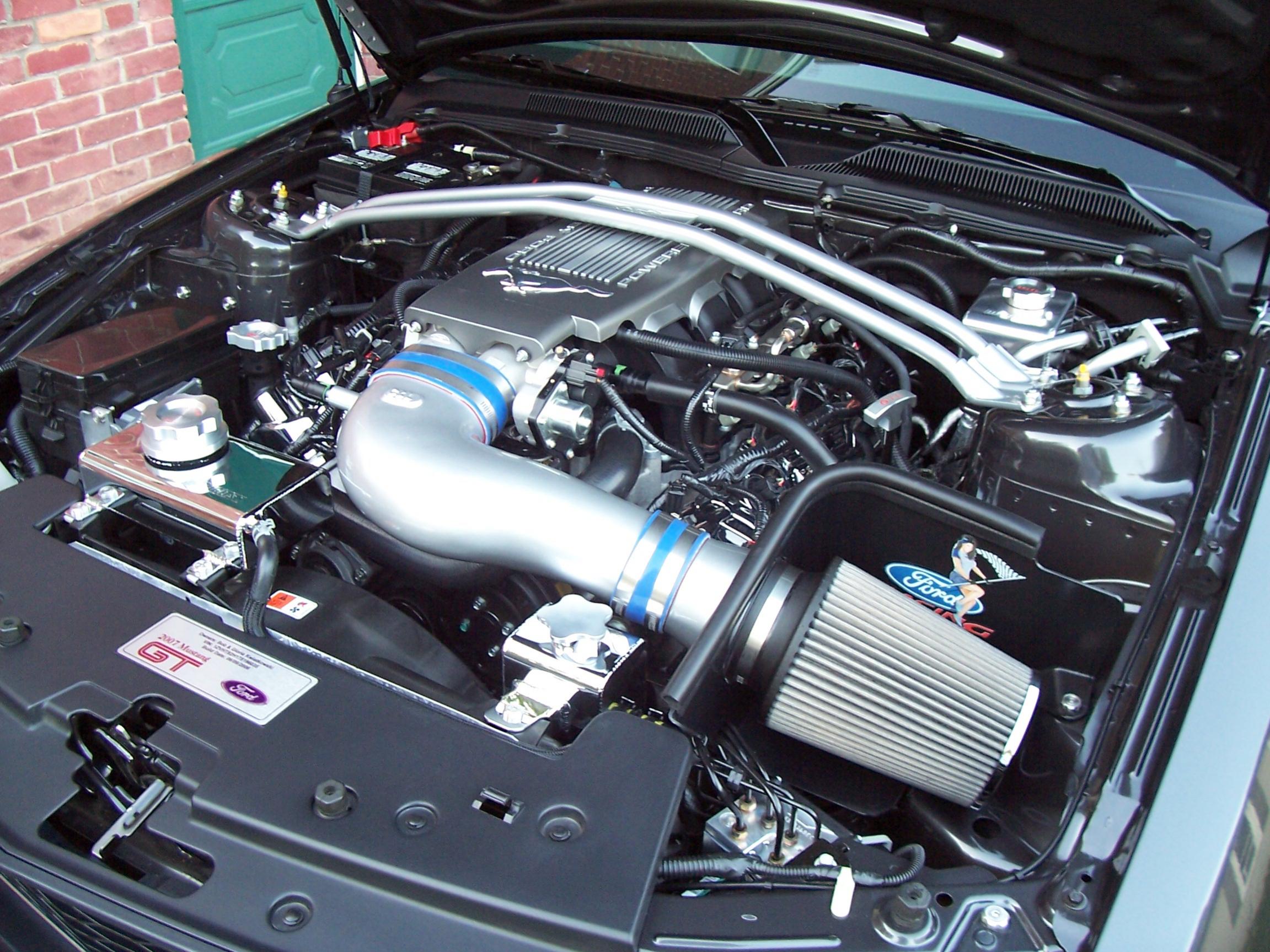

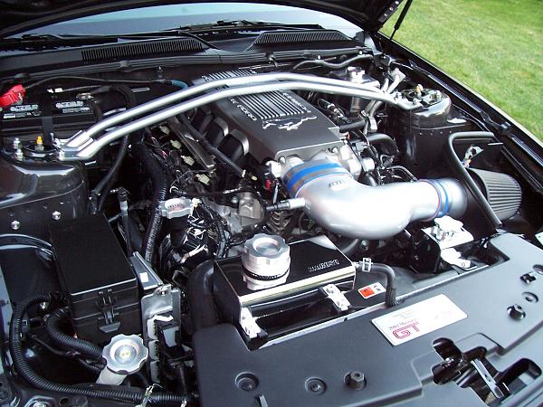

Here are a couple of photo's of the Moroso tanks in chrome.
I have a bunch of polished engine parts on a 1994 Miata we also own that are not clear or powdercoated.
I just polish them a couple of times a year with mothers billet polish and they still look the same after 15 years.
