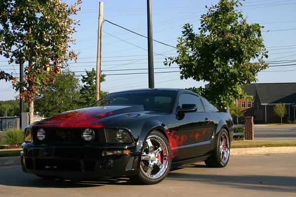

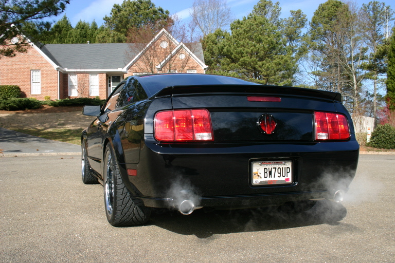

315's here on 20x 10.5's

I've seen some 335's, but I can't remember which forum I was perusing. 315's by Hireman and GI Joe both confirm it. Use caution with the backspacing and there'll be no issues. Joe was using Axis GT-R's. Bill, what wheels are those? They look great.
That looks awesome

Thanks! Their Boze/ ZE Forged 3 piece

Thats one of the best looking s-197's I've seen.Very cool!
