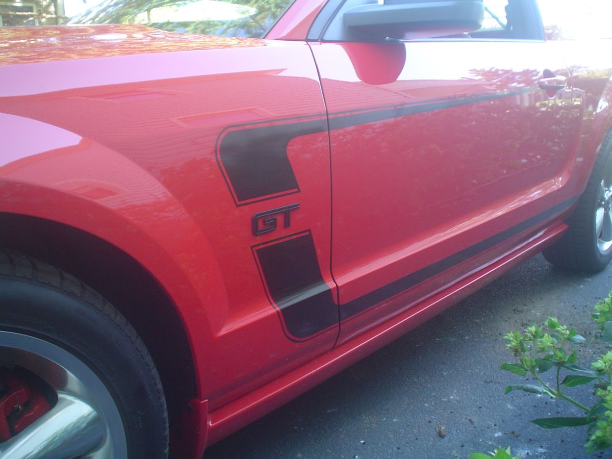

Painted my GT emblems black this spring.
Used Duplicolor satin black. Scuff with scotchbrite pad,degrease & paint.

I really like the look of that, it looks slick against the red. I'm getting a Black GT, so I was wondering on how a black GT logo would log against the black body, borrowing the black against black idea of the GT/CS black stripe. But kudos on that look, I like it.

Yes,
I removed the emblems,painted, put on new 3M tape & reattached.
There has been a few threads on taking the factory emblems off. You need to use fishing line, dental floss,etc. to cut through the tape holding the emblem on.

I used rubbing alcohol for degreaser, you just want to take off any finger oil from handling them prior to painting.
I painted my stockers, but also have a set of new take-offs in chrome I bought off ebay for about 5.00 ea. Just in case i screwed up
You can still find them on there, might be a little more now. Still better than 24.95 ea for factory.
