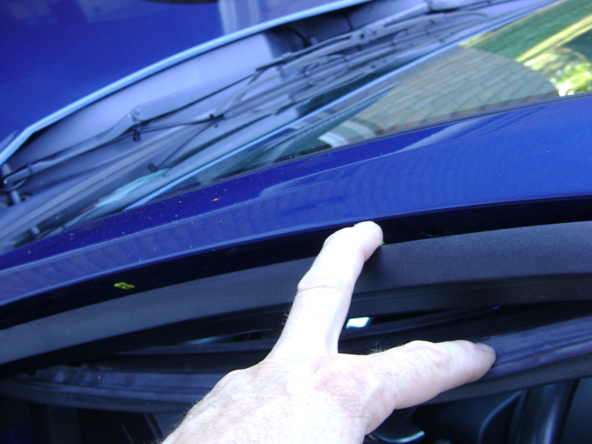

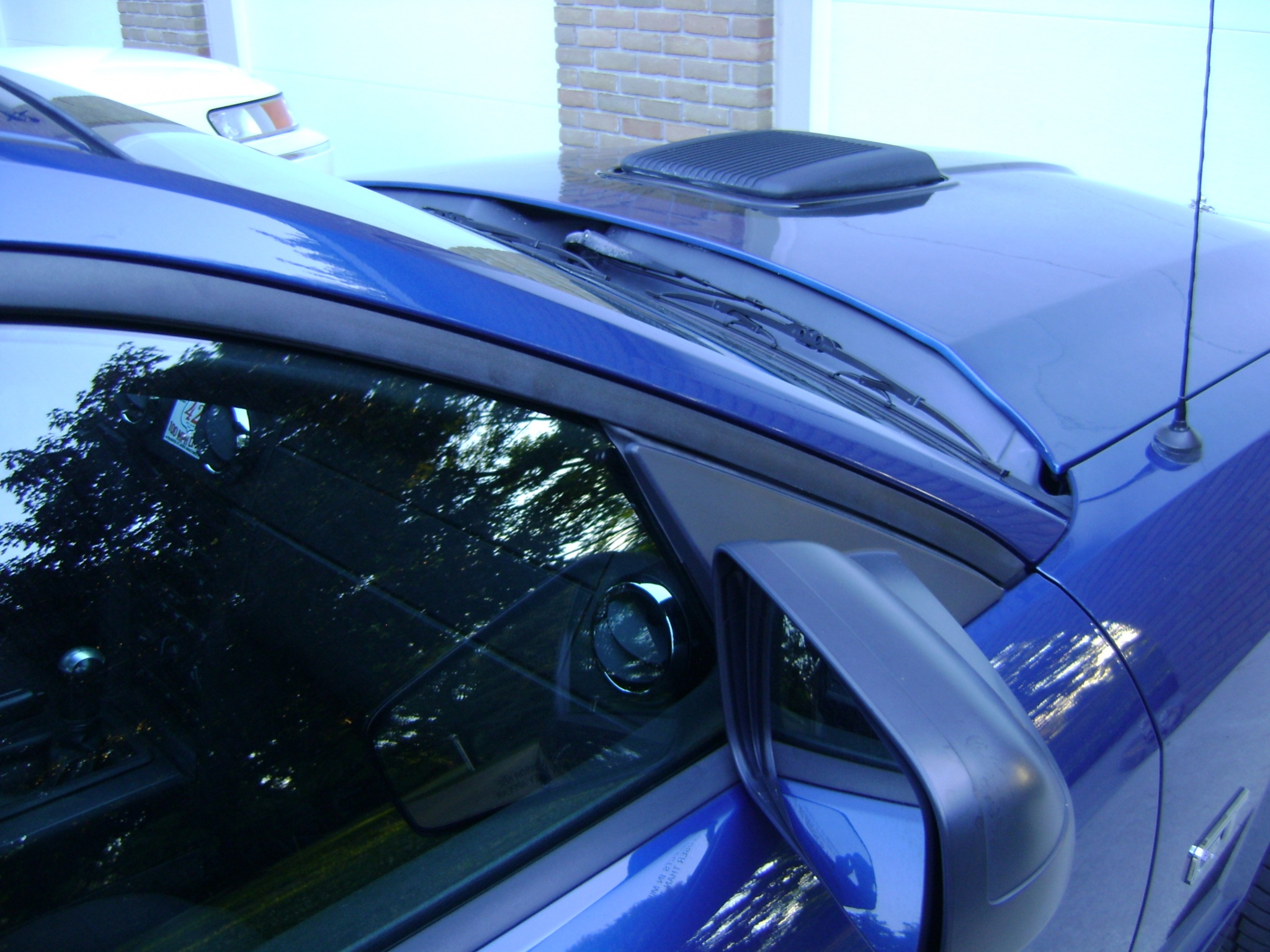

hmm...found them, but lousy pics...only one showing the rubber pulled out for access to the screws...might give you a idea of how it comes off, but sorry no better pics.
the rubber just kinda pops into the plastic, it comes out easy- getting it back in is a bit of a shoehorn job, but not bad...think there was 4 screws around the top, but thinking back I dont think I pulled the one side off completely- didnt think to get pics till the second side...
I was just replacing the front weatherstrip, only required pulling the front/top loose enough to remove the old stuff. in the pic you'll see a little yellow insert- the screws go into these, plus theres a couple molded in barbed pins that snap it in place pretty easy to pull off. the front weatherstrip *I think* was double adhesive, but mine had walked down and out into a wrinkled mess. if they were double sided adhesive, might be more fun to pull off. you will need new weatherstrip to put it back together- what I wanted to use was 1/4 inch 'wing seat tape' from the model airplane suppliers- but I didnt have enough...just used that gray one sided stuff from the hardware store- cant see it, so far it hasnt moved...the wing seat tape is closed cell/black, GREAT for stuff like this, I was just to lazy to drive 45 minutes in the other car to pick some up...
