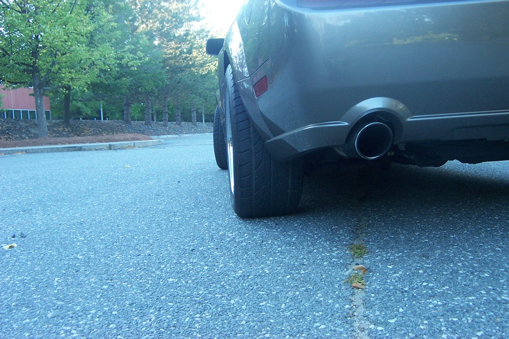

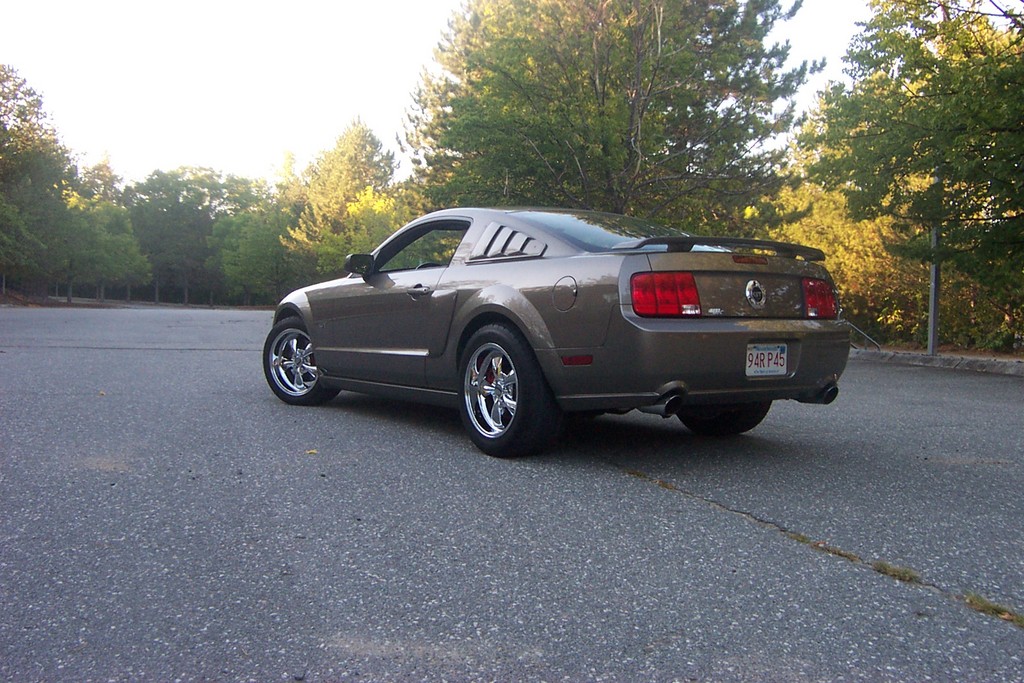

I have Nitto 295/45 om my 10" rims with no problems, I also got the complete setup at discount tire.com

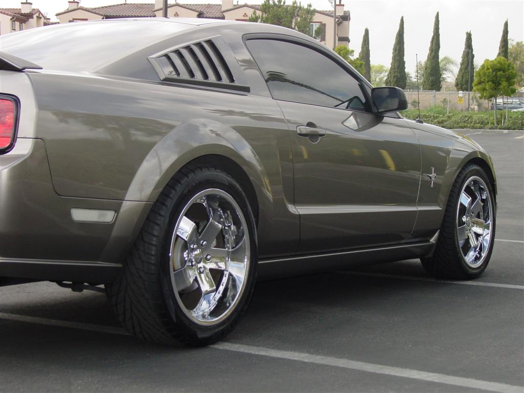

295/40/20 on 10 inch rims no problem....
